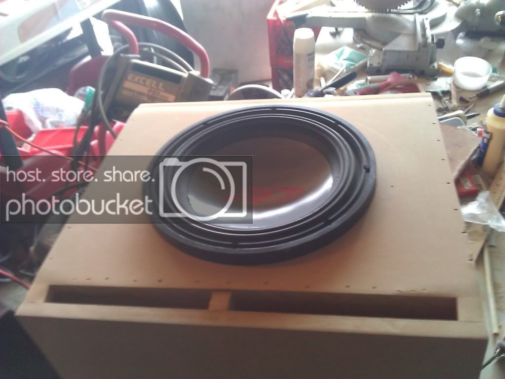

So this guy hit me up this morning "hey man i need a box for my 12" sub in my extended cab, I dont want it under the seat and I want it ported? can you do it?" and I told him sure and asked him what kind of music he listens to any everything. I did a box tuned 34hz and it kicked ***! i dont know what amp he was pushing it with but it was great for that 12". the box was big enough to still fit 2 people in the back. it was 1.5 cubic feet net. the minimum is .75 cubes and the max was 2 cubes so it was still specs. idk just shootin this out there for all the type r noob questions that ask "how should I do my box?" 32-34hz is your answer //content.invisioncic.com/y282845/emoticons/inlove.gif.6846f78f06b405429ef3a00129788a2a.gif
I'm helping a member on my car forums design a box for his type R. The info I found on this site seemed to point more towards 2-2.25 at 30-32
well this is the biggest he wanted for demesions. This box works great. i took a pic ill put on here too
It sounds amazing, the amp is an older 1000 watt pioneer amp with a tiny footprint. the specs were 18" tall, 20" wide, and i think 15" deep. 1" tall port, 18.5" wide, 25" long. I think I'm going to bondo up the box and paint it.
Well I meant the opening seems small for that. Thats only 12 sq in per cu/ft, I would have gone 14 or 15sq in per cu/ft.
Also concerning slot opening - JL Audio recommends against exceeding a 9:1 ratio for the slot opening, yours is just a hair over this.

this isnt jl audio, its alpine! lol idc man, it sounds great and the owner is super stoked
17.75" wide port with that little sitffener, and might have some real restriction in the corner, unless you rounded it a good bit. although, i haven't seen much luck with thin slot ports, but, if it works....
