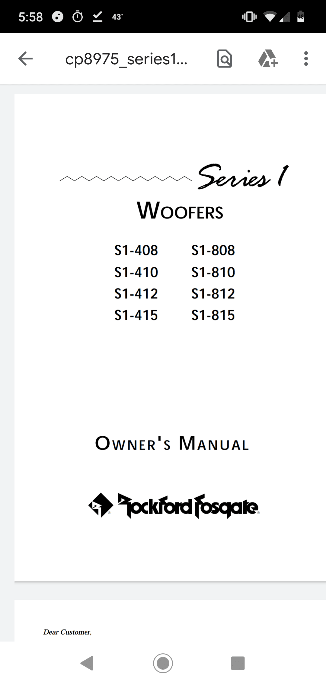

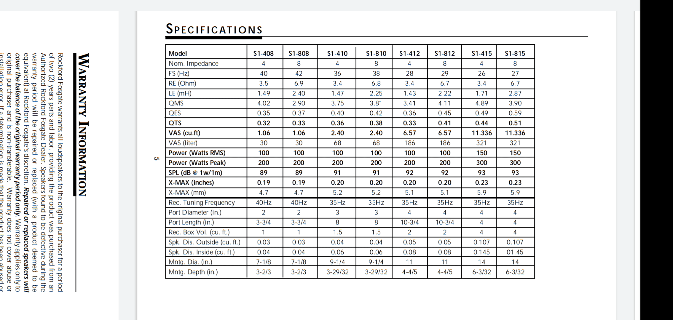

Do you think that this is a screenshot of the manual for the subs you are talking about?
