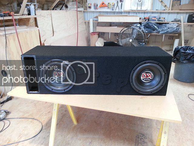

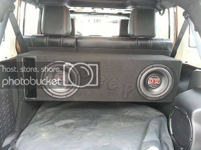

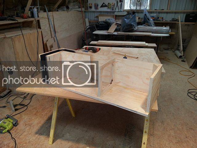

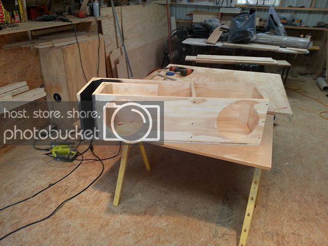

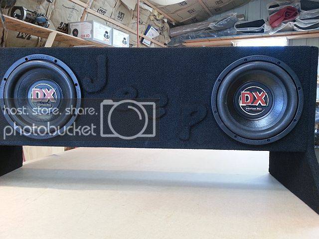

This is for two American Bass DX 10s......2.3 cubes net....35hz......It is raised up off of the floor to allow his tops to go in back....
