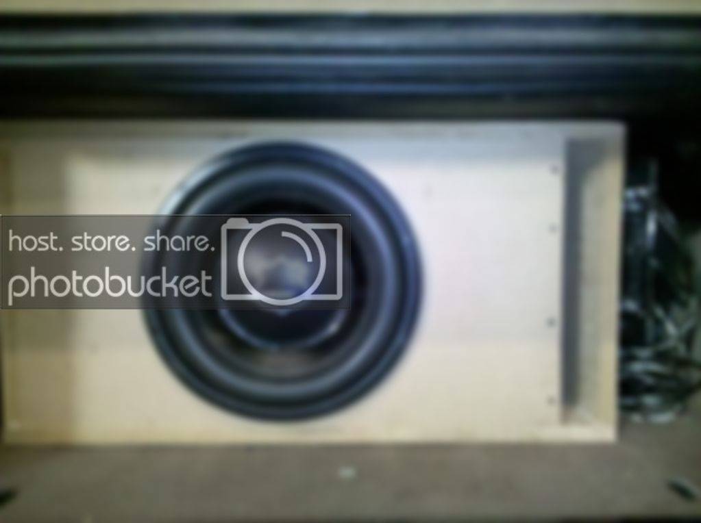

where is the sub going to go? i have the back seats taken out and have a 3.75ft^3 ported enclosure. some people go with a down firing sub with a port also facing down to evenly spread the sound, imo it doesn't make a difference unless you have the top down. this is what i have and it sounds great
