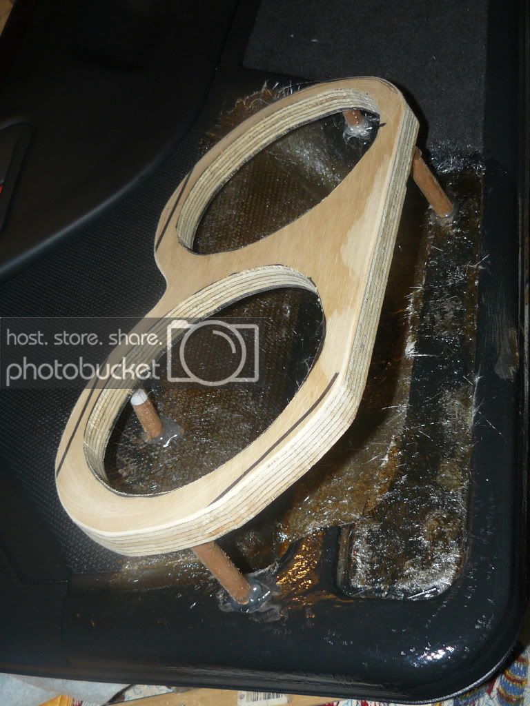

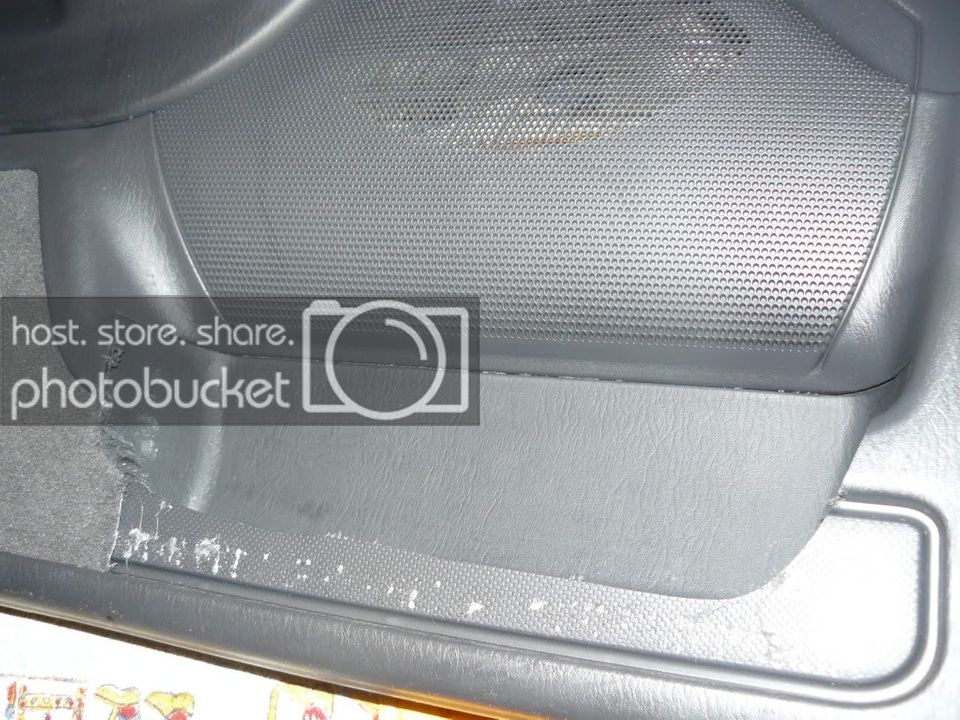

cutting up virgin doors
put plastic epoxy down, than resined over it quick and matted the area up, creating a stiff backside enclosure that'll be fully sealed when everything is done.

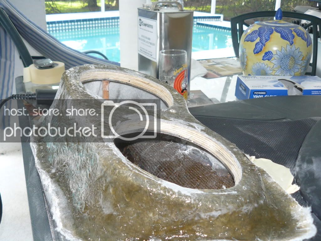

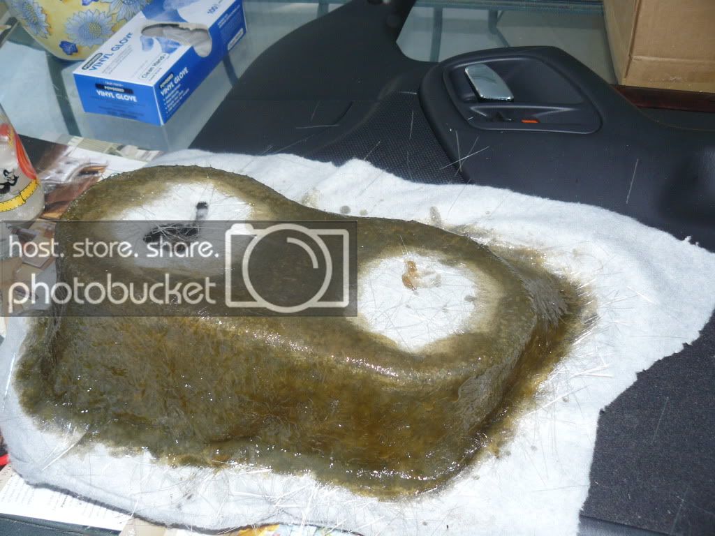

after last layer of mat (2-4 layers all around)
there is a whopping 30 oz of resin on this pod!!!!!

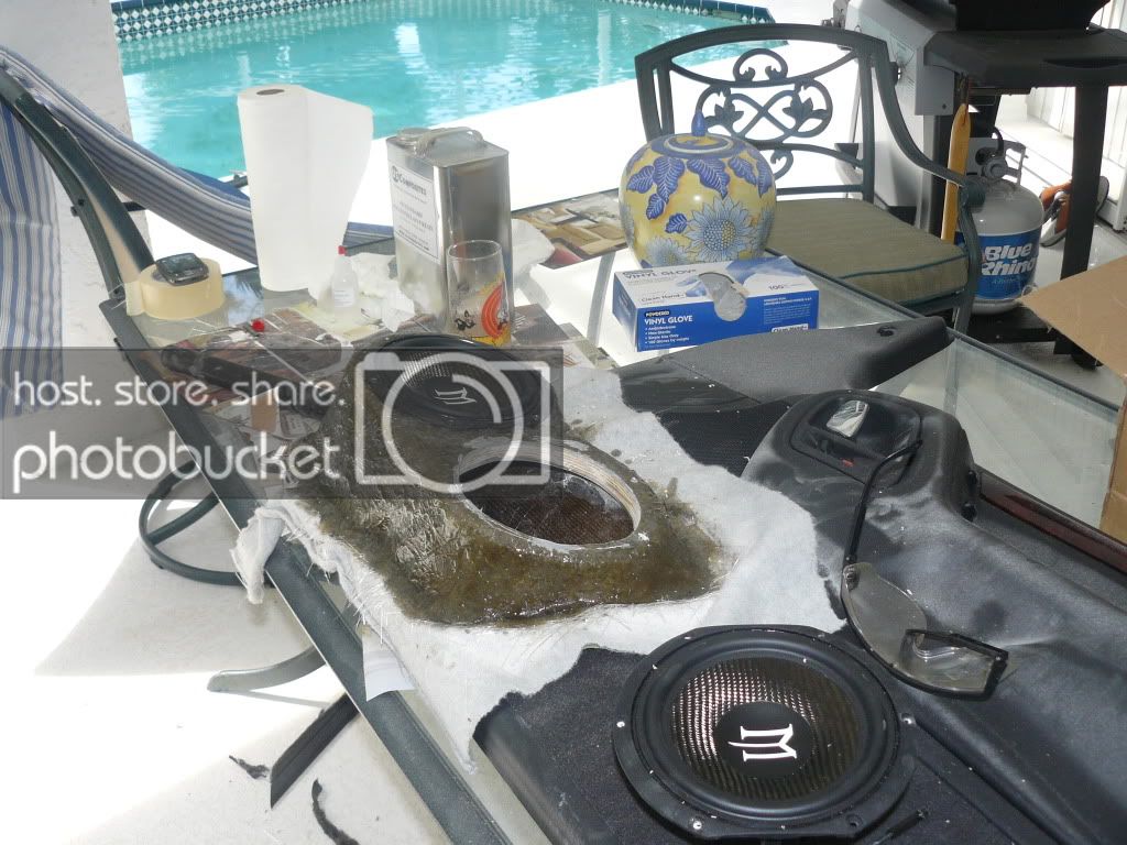

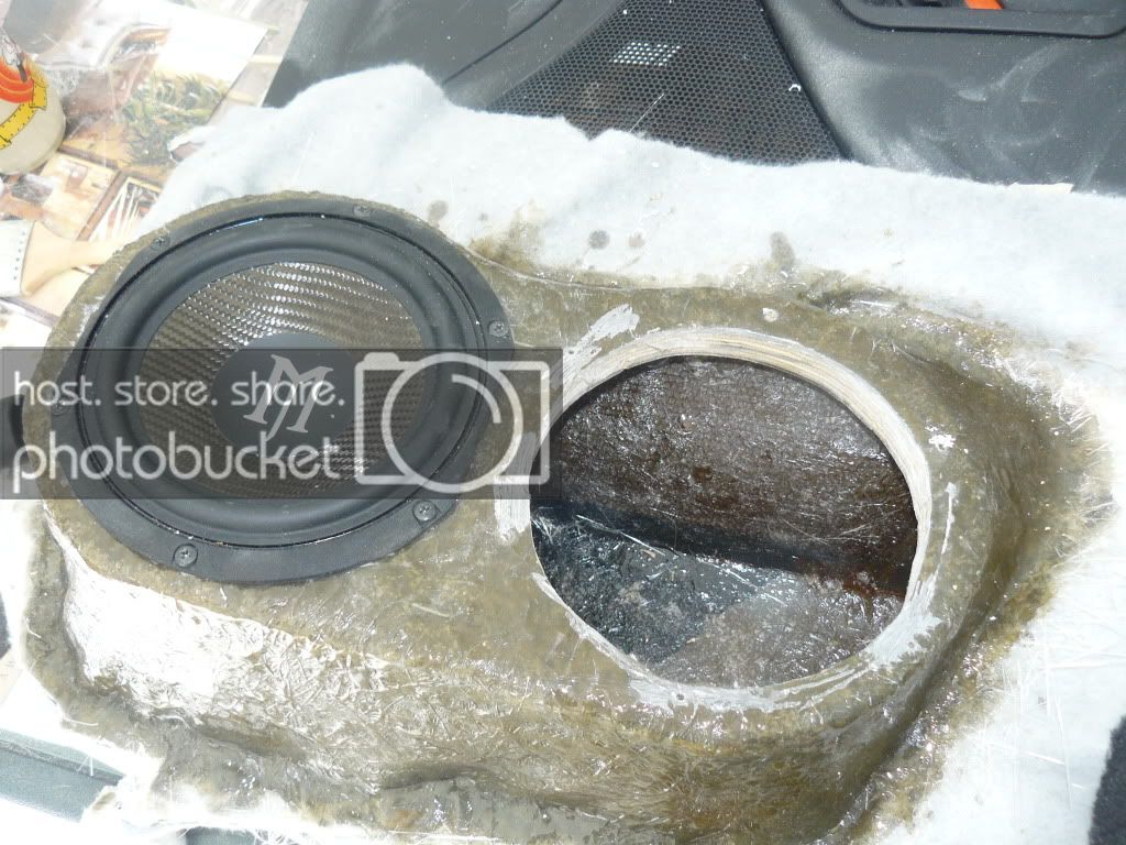

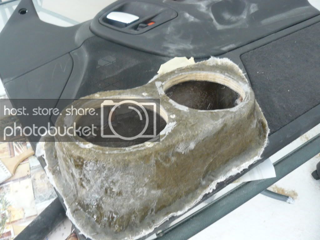

cutting out holes, test fit mids
trimmed a lil

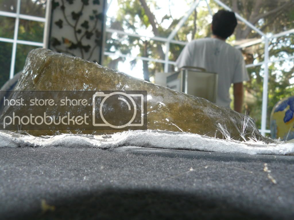

angle
my friend will be doing the sanding and finishing work on them,
That looks like a LOT of resin on there in the last pic. Have fun with sanding/body filling //content.invisioncic.com/y282845/emoticons/biggrin.gif.d71a5d36fcbab170f2364c9f2e3946cb.gif

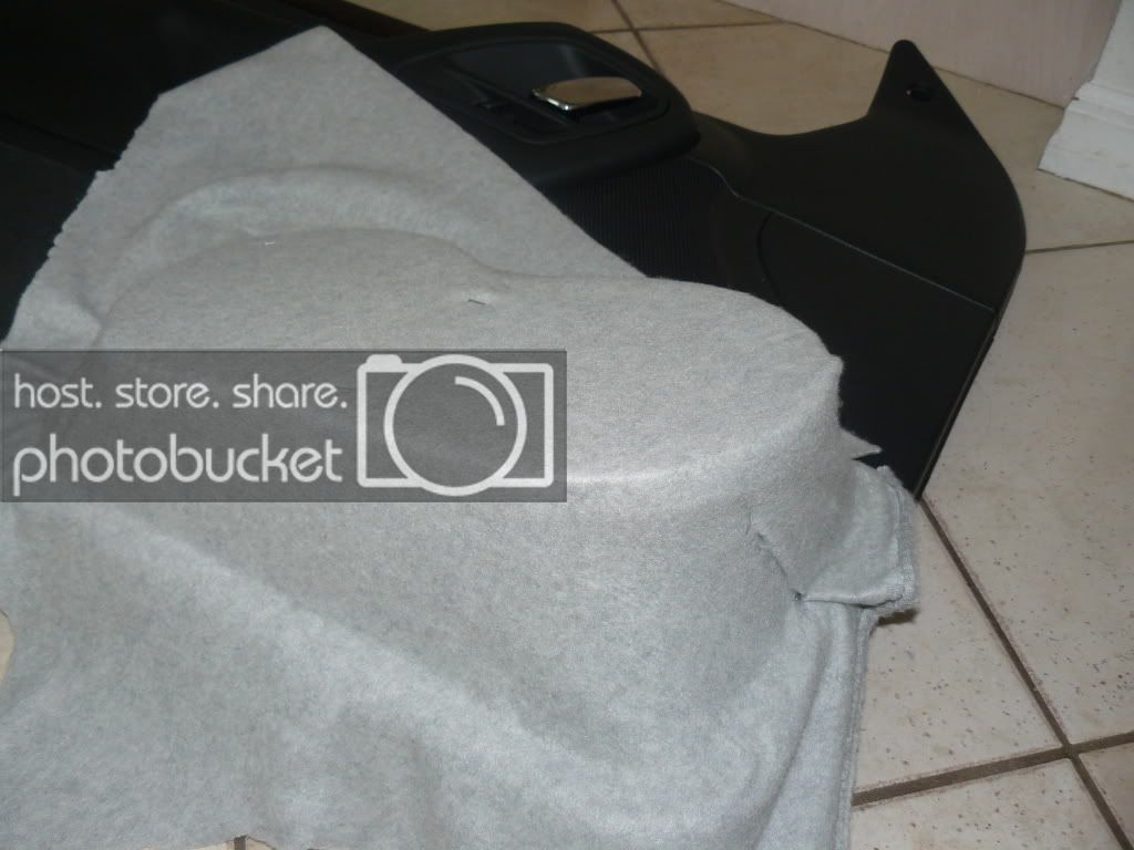

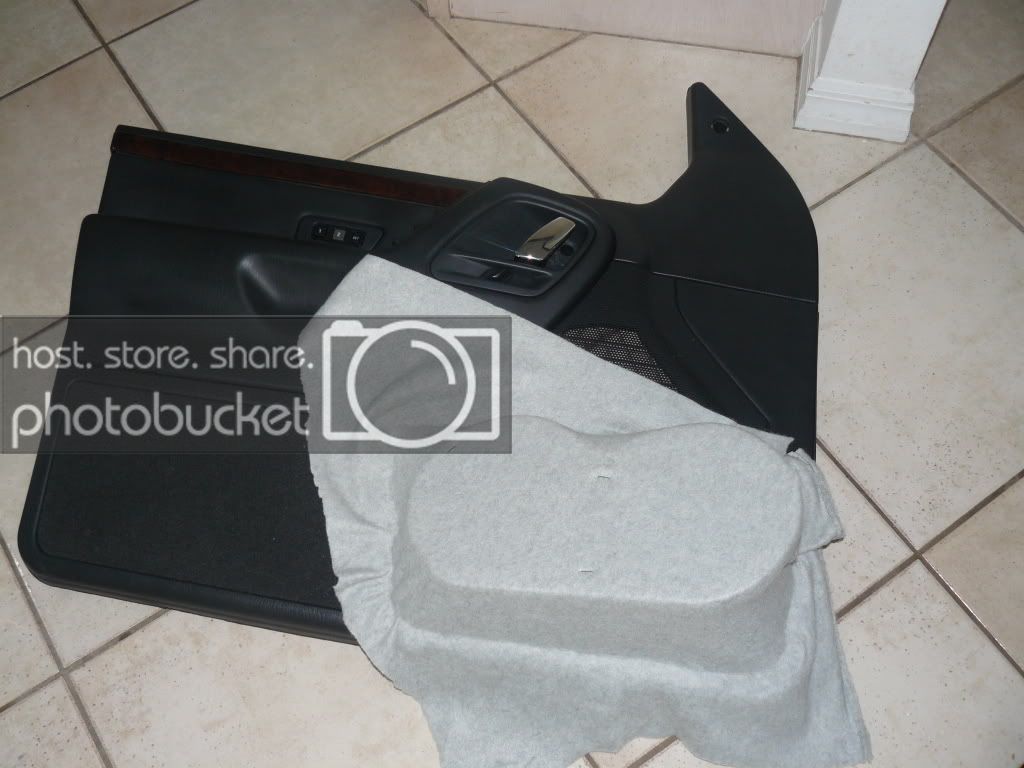

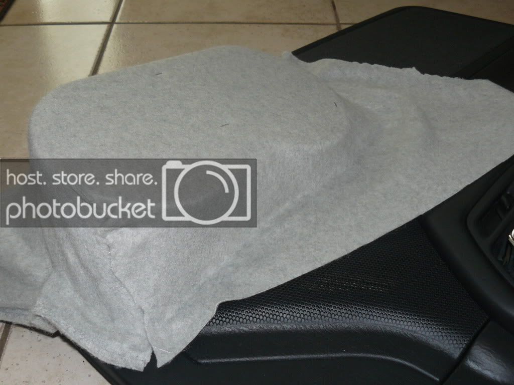

today i started the drivers side pod, just fleeced the pod shape
heres pics,
hot glue is where its at!
i screwed up a lil around here and had to cut and seam to avoid a big overlapped crease
i now hate fleece, wont be using it anymore myself in the future, should of borrowed some of this lycra material they use at the shop
Rabbet an edge into the outside of the baffle... staple the fleece into that edge... then after the resin starts to gel slice if off right above the edge.
Then you have a clean baffle to mount to. //content.invisioncic.com/y282845/emoticons/fyi.gif.9f1f679348da7204ce960cfc74bca8e0.gif

yeah i know thats wut i should of done, but i didnt, and so now the baffle needs to be sanded to be plane leveled all around, thats gonna **** //content.invisioncic.com/y282845/emoticons/laugh.gif.48439b2acf2cfca21620f01e7f77d1e4.gif

Shouldn't have made them sealed, thats way to small for 2 7s.
obviously the airspace is not ideal, but it is larger than it looks in the pics, the cutout map pocket is recessed into the jeep doors deep, so the pods are around 9-10 inches deep
