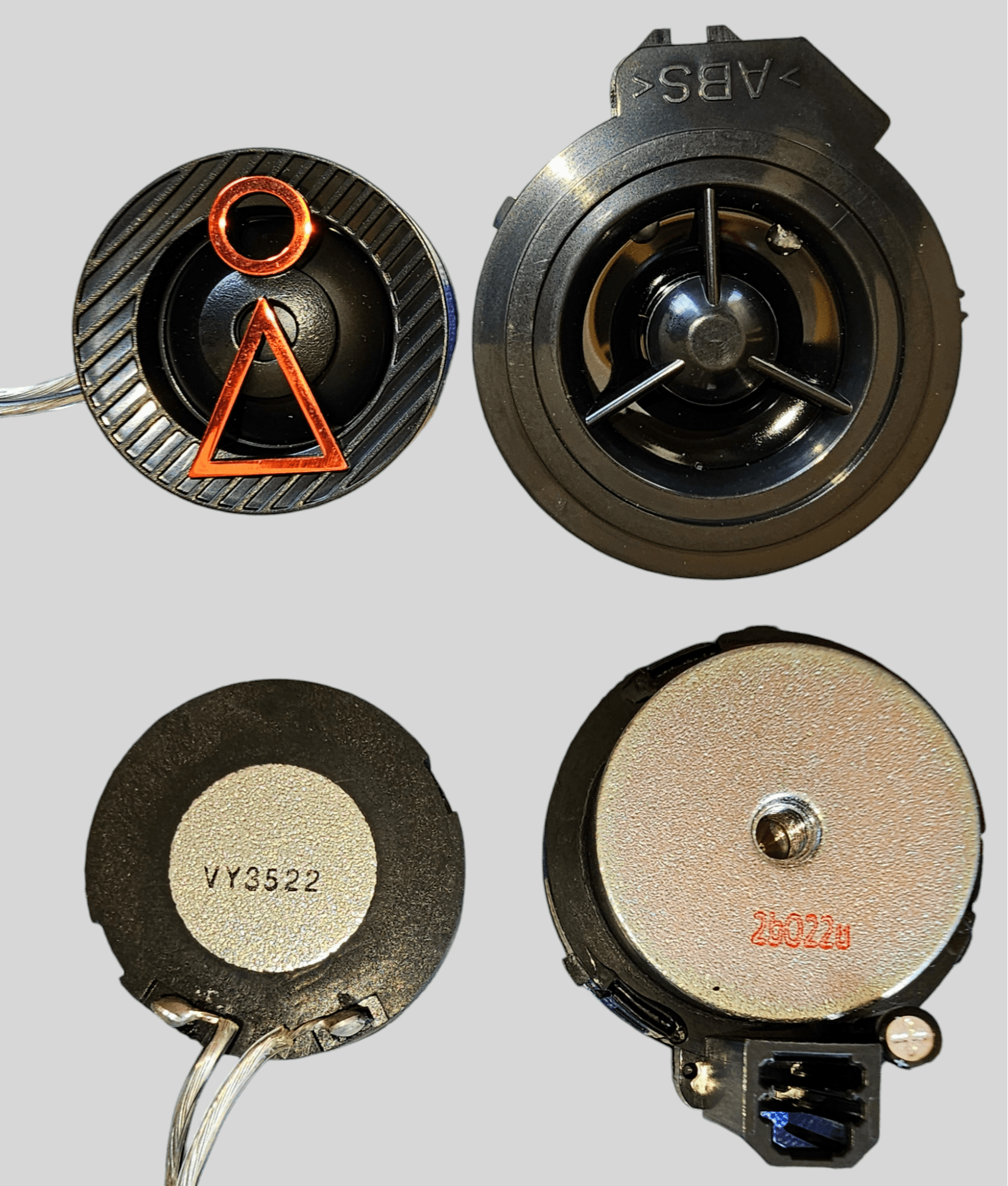

I just bought JBL Stage 3 607C 2 Way Speaker incl Tweeters for my car. When I compare the JBL Tweeters with OEM Installed Tweeters in the car I felt confusing as the JBL Tweeters are much smaller than the OEM both in size and magnet. I don't know the detail spec of both as there is no description. What I know are dome type tweeter for JBL and conus of the OEM Tweeters seems like plastic as it is shiny. Please see the comparison picture. Should I keep using the OEM Tweeters or replace it with JBL Tweeters?

The "Appearance" is irrelevant, they're speakers, not apparel ;)
I'm not fan of the PEI drivers, too laid back for my taste. They are crossed at a very high 5000 hz, I like it when a tweeter can handle the 2000-2500 hz and up range. I also like a metal dome. That said, they most certainly will outperform whatever came stock in your car unless it's rather high-end OEM system in which case, you'd likely not being looking for improvement anyway.

The magnet on the JBL's is made of Neodymium, which is up to 10 times more effective (magnetic energy-wise). That smaller JBL magnets is probably several times more powerful than the OEM.

Woow, size doesn't matter. Love your explanation.
Always like to put opportunity out there. Now that I have seen the pictures, it appears that you are making a lateral move, from one PEI dome to another. I can't honestly say that there will be a significant difference. The JBLs are probably better but it's marginal as to how much. Additionally, the OEM speakers are often very efficient at the cost of power handling ability and aftermarket speakers are often just the opposite, not as efficient but can handle much more power. When you replace them using the stock OEM system internal amplification, it often comes out with no real gain. Adding an aftermarket line level converter and an aftermarket amplifier will usually make a real difference and utilize the JBL speakers better. Something like this (all dependant on the stock system you're starting with)

I forgot to mention that I already changed OEM HU with an android one. It's much better than OEM HU.

I have not heard those jbls, but I do think they'll at least be an improvement. JBL isn't known for making bad products. They make everything from basic to their $2k+ Arena line.
As far as aftermarket head unit, almost all of the built in amplifiers are 22 x 4 RMS (they also are all usually 50 x 4 max power, which you should always ignore max power and go by RMS ratings). Whether this is enough power for you or not just depends on your personal listening volume preference.
Try them and find out!
