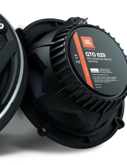

Hello, I have just installed 4 JBL GTO629 6.5 speakers to replace my stock Beetle speakers and also purchased a JBL SUBBP12AM for the trunk. I’m also considering the JBL Club tweeters.
I’ve ran the Boss wiring kit from the battery and I’m not sure what to do from here.
Also I have no idea if I need the 4way amp for the GTO speakers or not but I’m using an android radio head that has very little boost for sound.
Do I wire the sun by itself and reserve its amp for the 12”?
Where can I wire the smaller amp for the 6.5 GTO speakers, can I wire into the existing speaker wires to connect to the amp and then give it power, memory and ground? Or is there a way to piggyback off the sub?
Do the tweeters also need to be powered by the JBL studio amp?
What is the best way to utilize this setup?
Thank you in advance!
