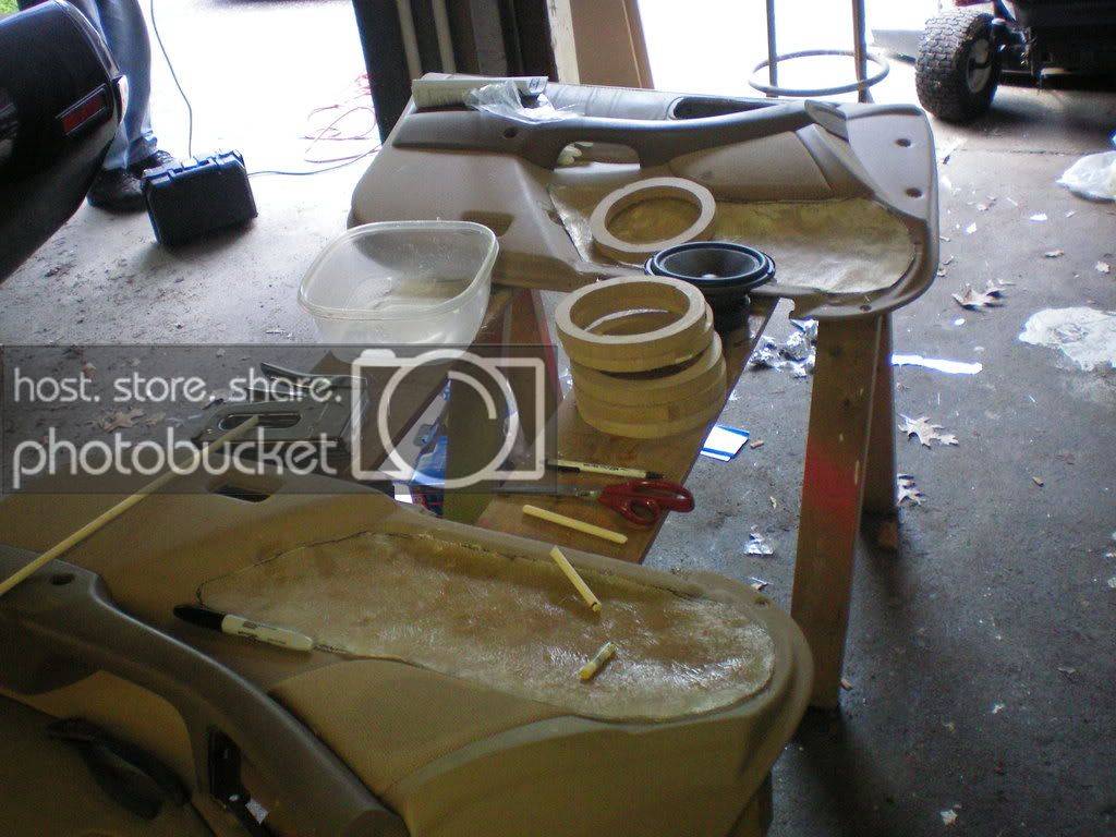

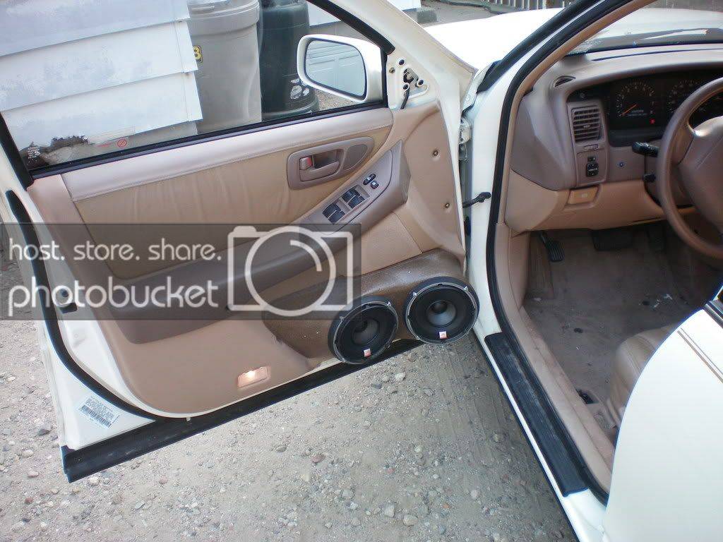

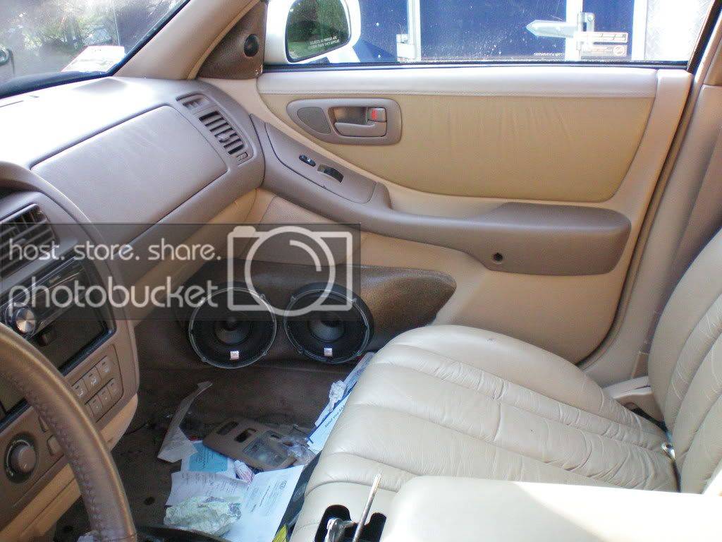

so heres some build pics of the fiberglass work and semi-finished pics, this is my daily car and i needed to get to work, so i never really got it 100%, just flecktoned the pods and called it a day, im considering just rebuilding them with a ssmb8 and ss 6.5in comp system in each door and wrapping in vinyl, i heard a set recently and loved the clarity and volume, the mids sucked tho, but an ssmb8 should compensate.

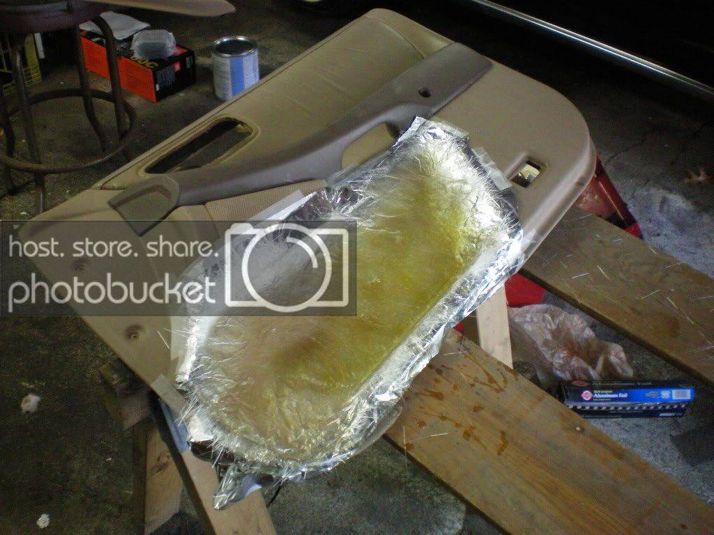

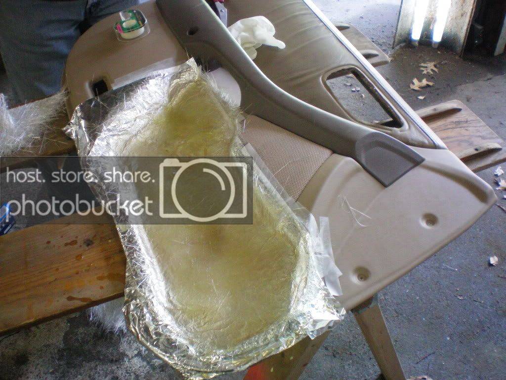

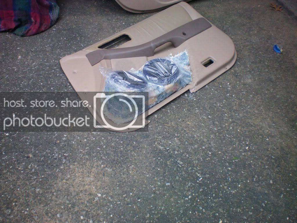

took the doors off and made a mold of the bottom part where there was a pocket (it just unscrewed from the back, gave me a nice area to throw some speakers in)

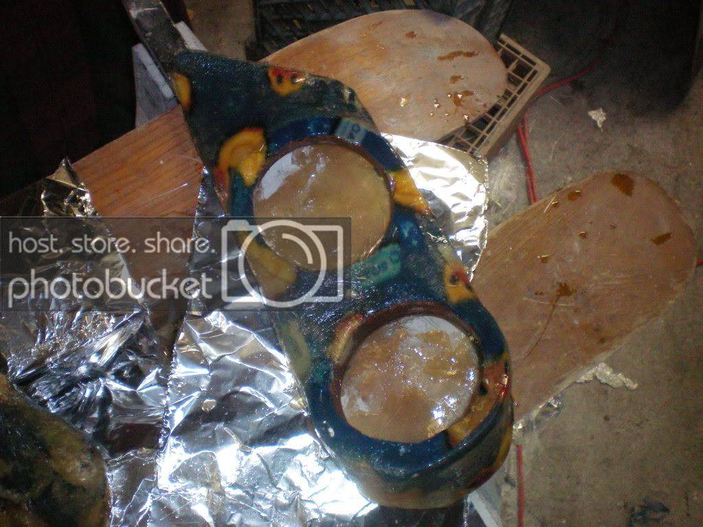

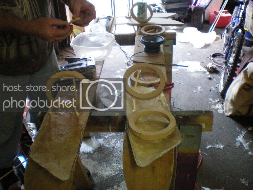

6 rings cut with a jigsaw...not a half bad job if i may say so
supported with i think it was 3/4 in rod and hot glue...not the best idea, should have made it stronger for wrapping

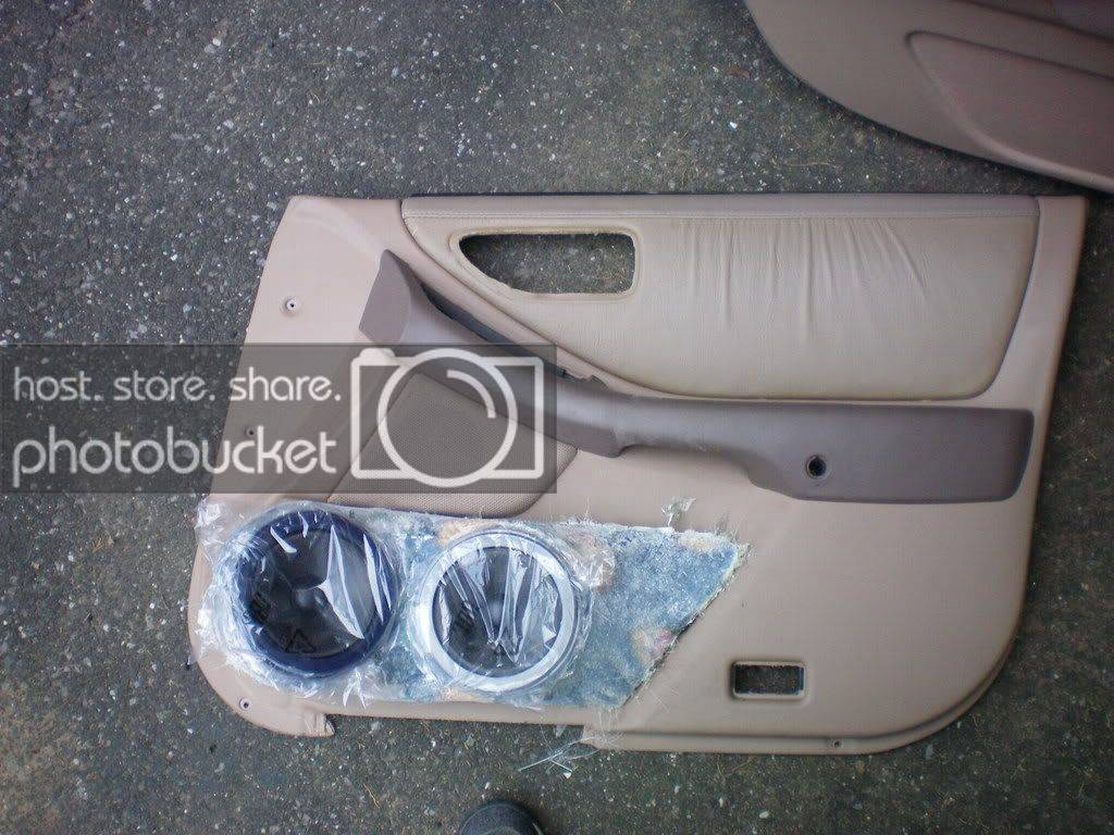

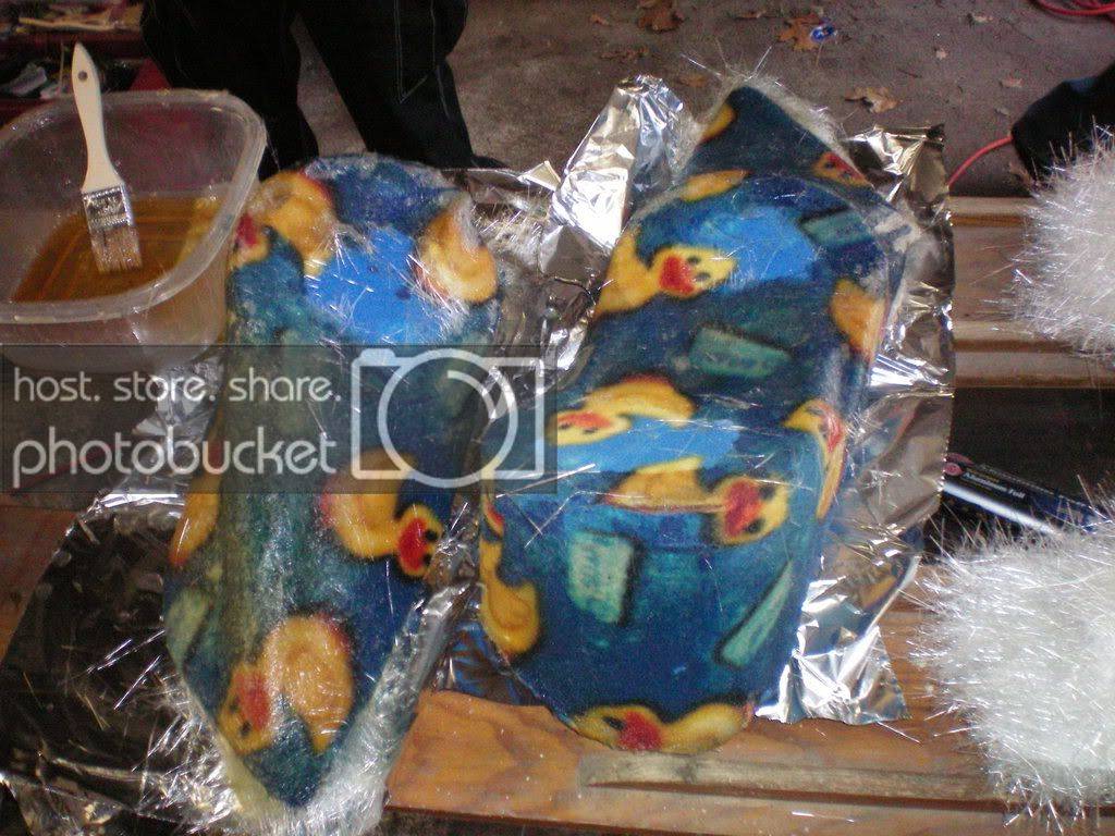

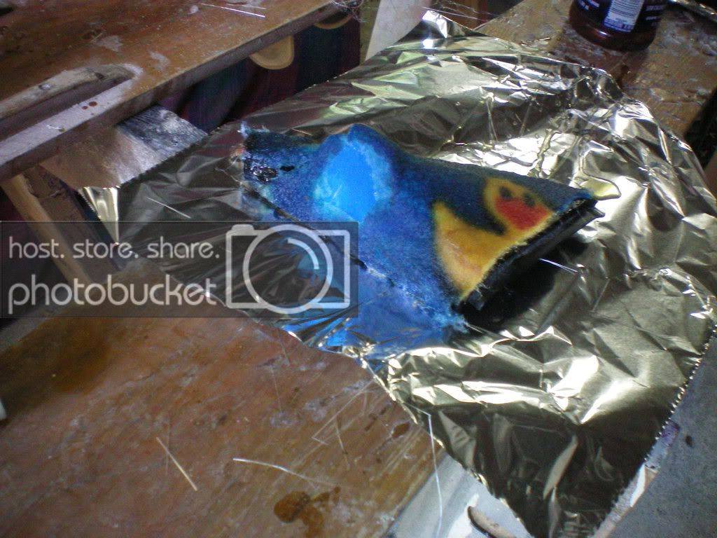

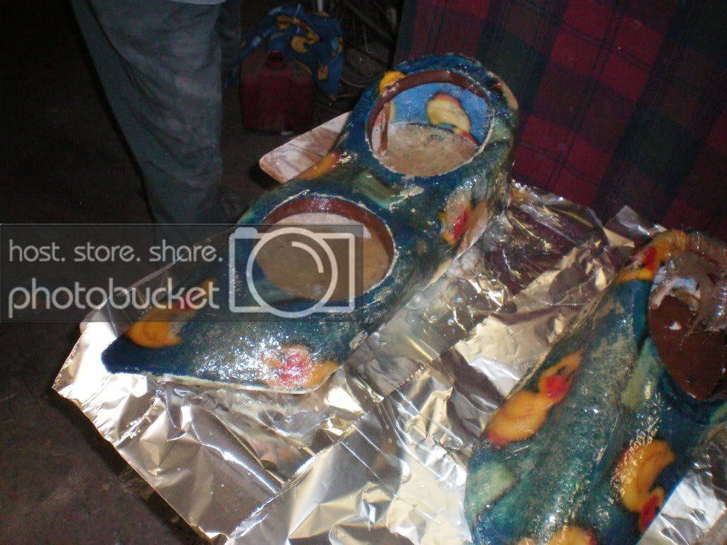

wrapped up and some resin, i didnt really take pics of the rears, i just pulled the carpet off of the bottom of the door, traced it out on mdf, cut it out, mounted a ring, wrap/fleece/glass/bondo/flecktone/mount
test fit

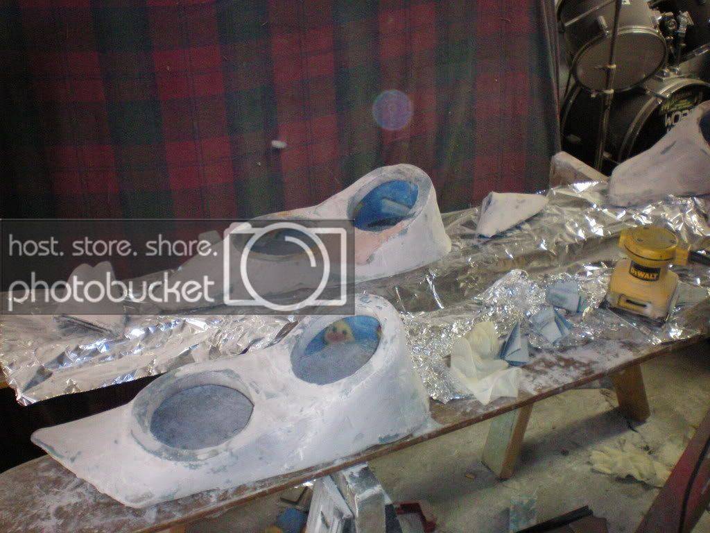

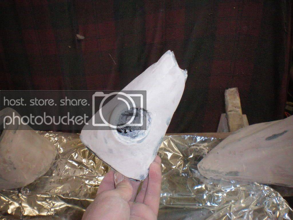

a pillar pods for 1 tweet...
other mounted in vent
bondo...

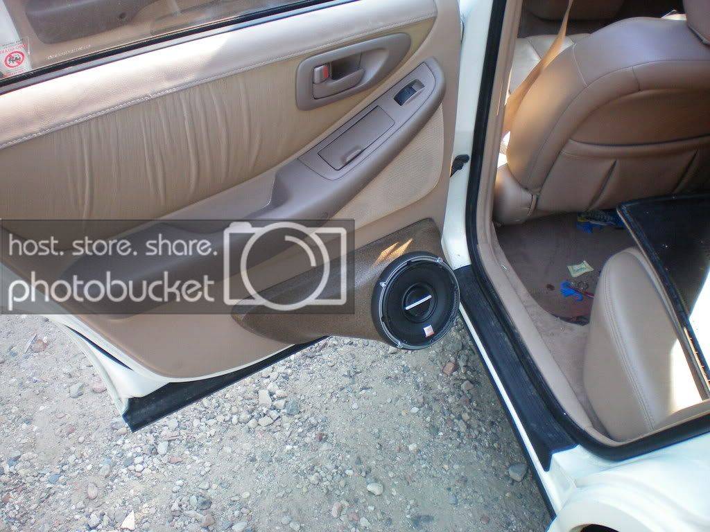

painted and mounted

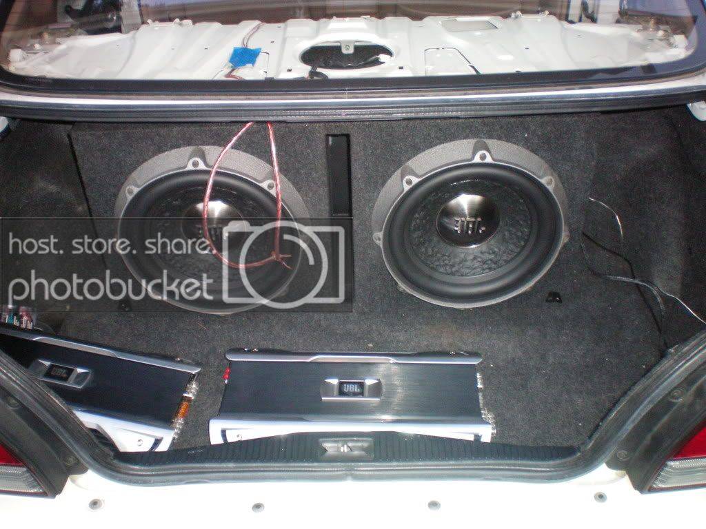

8in kicker vent cut into rear deck cuz im dumb and was bored...did nothing whatsoever, box comes so close to the top

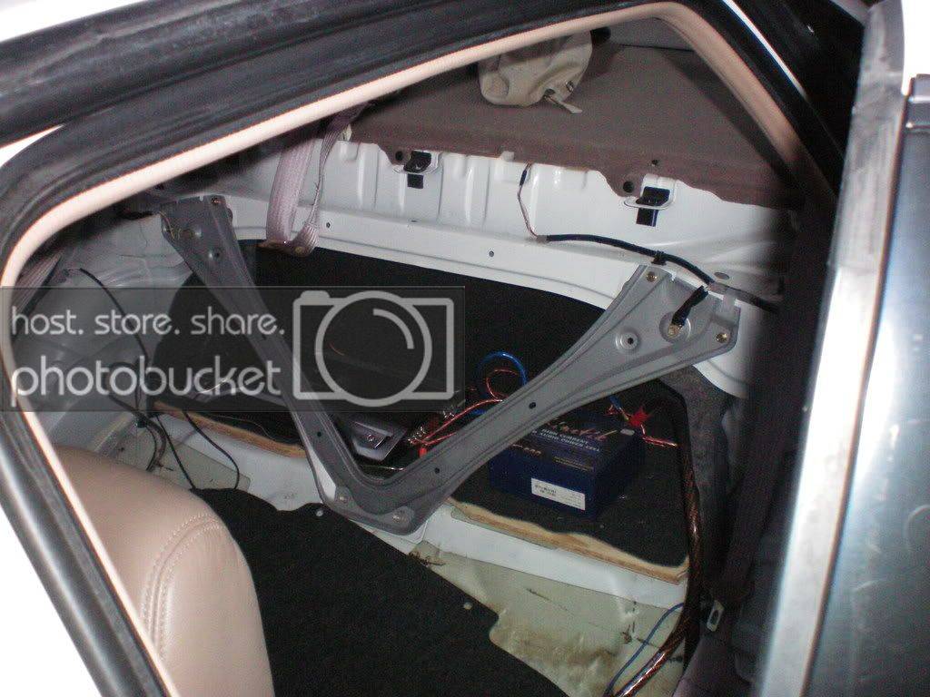

subs and highs amps...theyre basically mounted there now, just stright and wired and theyre just kinda there, nothing is covered or anything, it looks like ***
hc600, sub amp with rear seat out

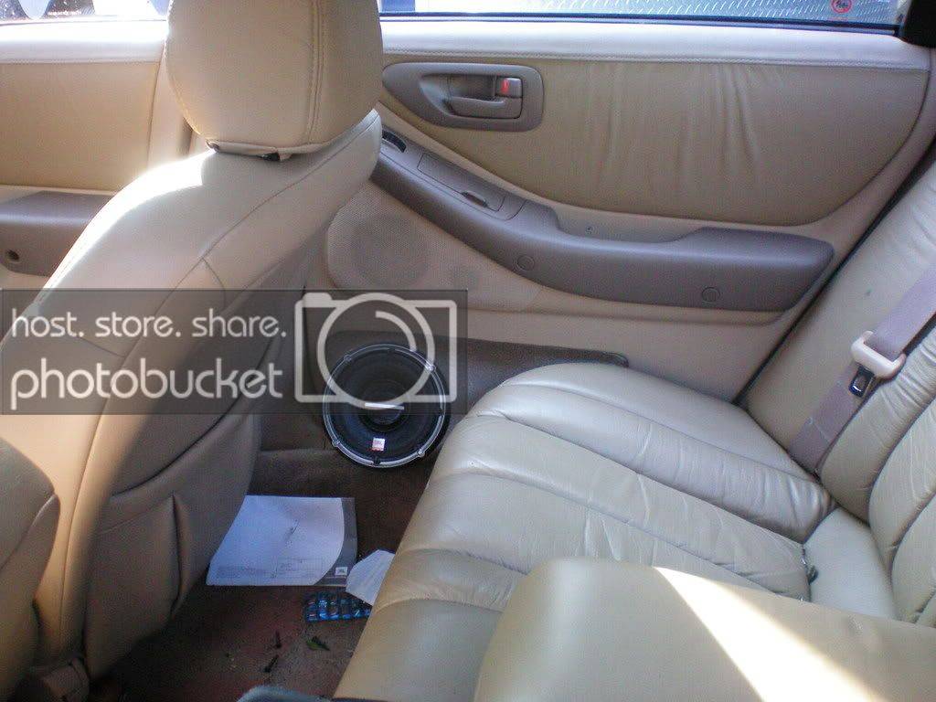

so the idea is, either 2 15's in rear deck ported through armrest in back seat (looking at new sundown z15's) or 6 boston g5's in a fiberglass box using the spare tire well and a larger hump with them all mounted inverted(i can easily get the 6 cubes sealed they need back there)
any suggestions? budget isnt so much of an issue, anything huge has to wait till summer

my friend works at jo-anne fabrics and basically gave that stuff to me cuz i told her i needed fleece, i think it was 5 bucks for like 3 or 4 yards
but everyone loves the ducky print

Honestly I think the pods came out pretty good for sure, but why not go with a 8" mid bass in the door with a 3"-4" mid in the kicks (some more Fiberglass work for ya) and then get the tweeters into the a-pillars firing across at each other. Might no be the perfect setup for your car but its a good start on placement of gear. Ditch the speakers in the back doors and should be good.
As I said I think the pods look pretty good but just need a bit more thought on gear and placement and aiming of the drivers. You certainly seem to have the skills to pull of some pretty sweet stuff.
EDIT: The SS comp idea you have sounds pretty good, looks like you might have the room if you go up into the factory speaker area to get the 8" MB and the 6.5" mid in the door and then get the tweeters up on the pillar, or maybe both on the sail panel like you have on the passenger side. Bridge one of the 4-channels to the 8's and then the other can be used on the comp set.
like i said, this was kind of a 4 inch coax isnt going to cut it with 1200watts of bass so i need something, anything, so why not learn to glass pods(my dad is a marine mechanic, i used to be his assistant as like my first job when i was 13/14, so i learned how to glass boat hulls and stuff, never really did speaker pods)
these pods are way overbuilt...the front ones hold my 200lb 6 foot 1 body standing on them, the design needs refining, which is why im here for some advice.

back doors are out, they got kicked too much, just gonna sell em to a friend sans destroyed grills and throw away the pods, redoing something back there would have to be something more creative, that design was waaaay too in the way

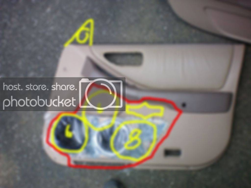

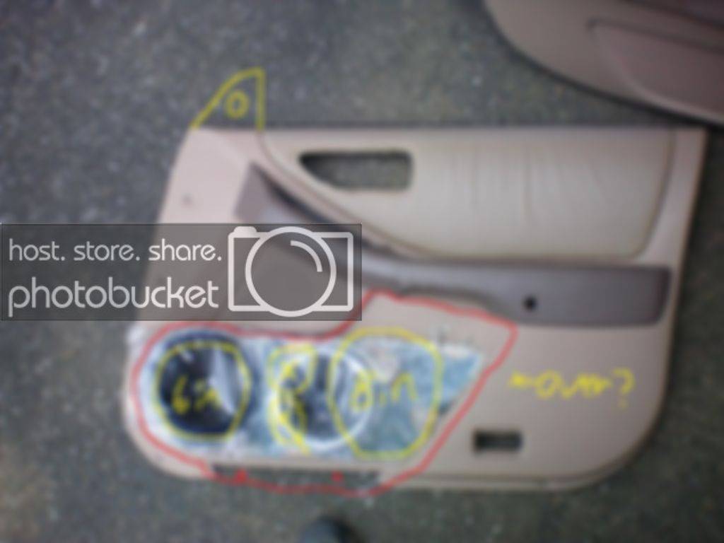

red line is new outline of how big the pod will be (part on bottom gives me access to 2 stock mounting holes)
yellow is placement...i guess see how stuff goes together as to where crosovers go, right now theyre basically screwed to the inside of the door, where it says"x-over?", the ss ones are much nicer, may want to display em
my plan to fit the 8 and 6...it should work, theres a lot of clearance in this car as you can see fron the pic where the door is closed up above. door to seat is like 5 inches, i should be fine on depth/enclosure volume. it would be 2 separate chambers.
any suggestion as to aiming of the 6.5? just straight out? something like i have now just angled up more?

Plans look pretty sweet should come out good. Aiming the passenger side mid at the drivers side headrest and the drivers side mid at the passenger headrest should work out pretty good. Tweeters have a lot more choices on aiming but some experimenting isn't too hard and seeing whatever works best for you. Laser pointer works pretty good for aiming the speakers, you can wing em pretty easily and all but the laser pointer definitely helps in getting the aiming down.

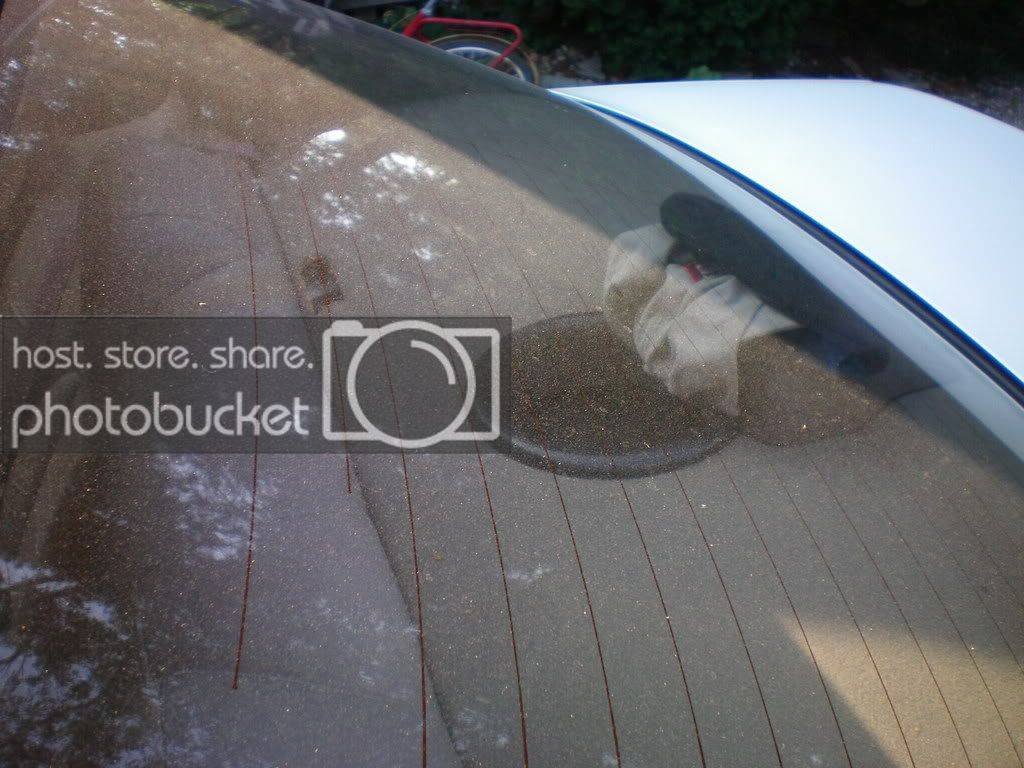

the vent tweeters were honestly cuz i had nowhere else to put them, i ran out of ideas and driving to work every day with my dash half apart, all the door panels, trim, rear seat, etc out was really getting to me, i had an extra set of tweets and it took less than 10 mins to hot glue em in there and wire it up, and yes, everyone jokes about moving the vents to change the staging, i get it, retarded move

and because im a fan of exess...plan b: red lines=pod boundries, yellow is speaker placement, that weird thing over the 8 is a bad attempt at the kicker logo, which would look pretty sick imho

and if anyone has experience cutting out the rear deck of a toyota and throwing some 15's in a ~6 cube box with 3kw ported through the armrest, leave a comment, i might need some help with that one, lol.
