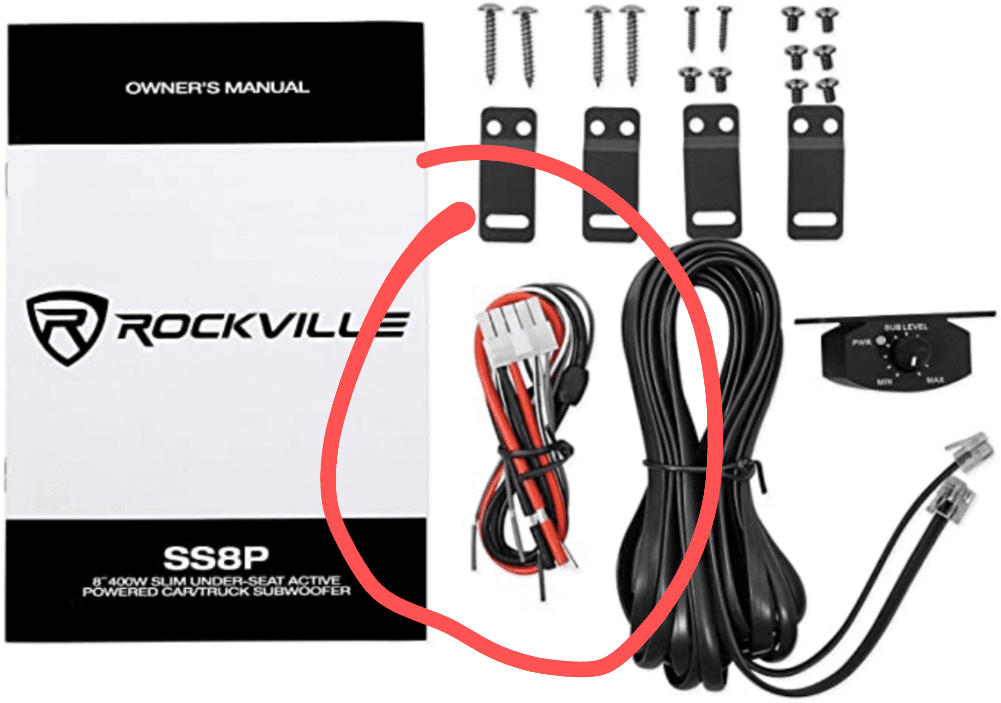

So here's the weirdest part of this amp/sub. The wiring harness that came with it has maybe 14 gauge wire one it. I attached a stock photo of the harness. The directions recommend an 8 gauge kit. So a significantly bigger wire. The current location of the amp is about 4 inches from a ground bolt, so I didn't attach any of the 8 gauge wire and just grounded the lead from the harness straight to that bolt. So I'll add some 8ngauge and run it to a different ground spot and see if that helps out.

Dang. Well, then with the ground being right there, and an 8 ga. is feeding the 14 ga. positive, then the ground being 14 ga. and the body bolt is 4" away, it shouldn't have an impedance issue.
