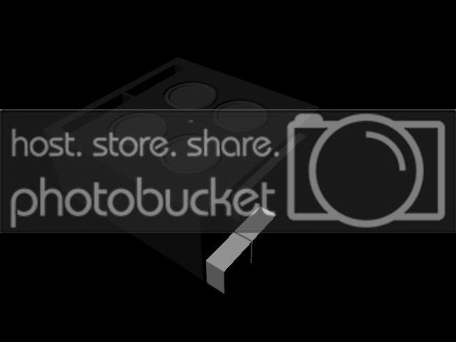

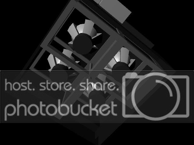

is this enough bracing?
taintedplay
ok subs will be 4 15inch re se's off of a aq3500d
1. one threaded rod down the middle, is that enough?
2. ill have a flushmount baffle(as shown) but is two sheets plus the beauty panel ontop needed?
3. also, i only have room to mount the aq on the box, if i have that side double thick mdf plus rubber grommits, is that enough to stop vibration/flexing?
id rather be safe than sorry, and since my amp is going to be on the box i really want to be safe. heres what i think ill do. 1x1 board run around like i showed, does it matter what type of wood?
then allthread down the middle, and between each sub. then on the wall with the amps, have it double layered
