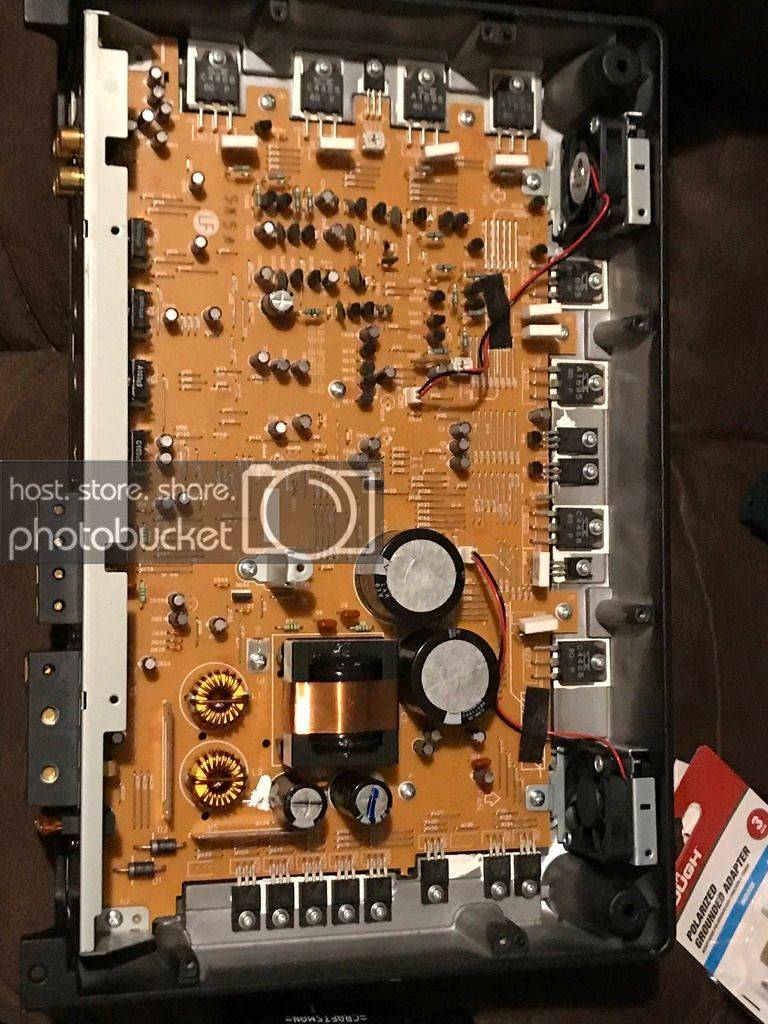

Can’t use this method on the KAC-7204 that thing is a hot plate even taking it easy on it. Gotta love when you have active cooling fans and the thing feels like it’s ready to reflow it’s own solder all the time.

Yeah it works but it’s got some of most weak sauce amp guts I’ve ever seen in person. All the caps big enough to fit the temp rating is 105c or it probably wouldn’t have lasted as long as it did.
Edit to add pic
