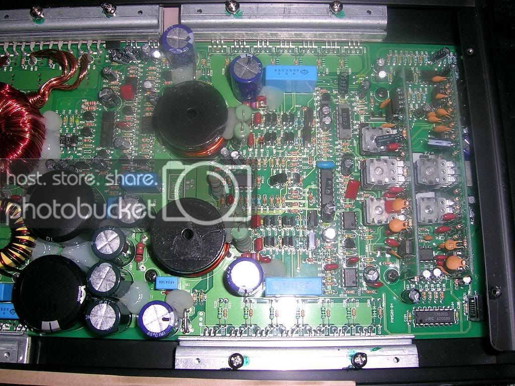

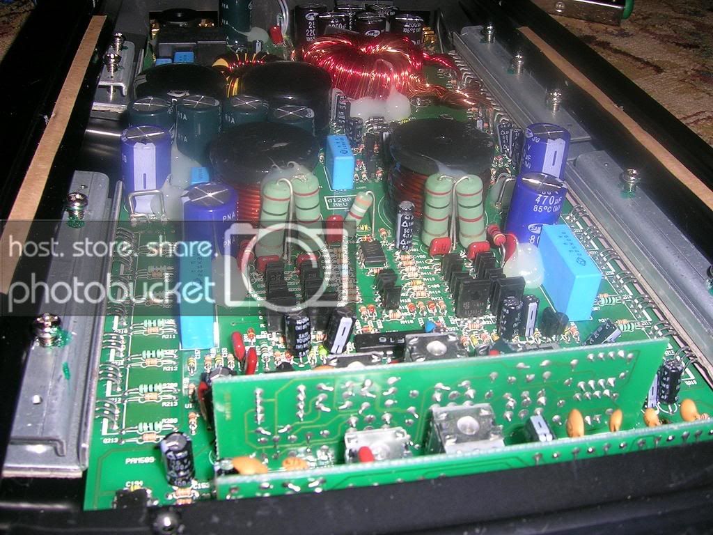

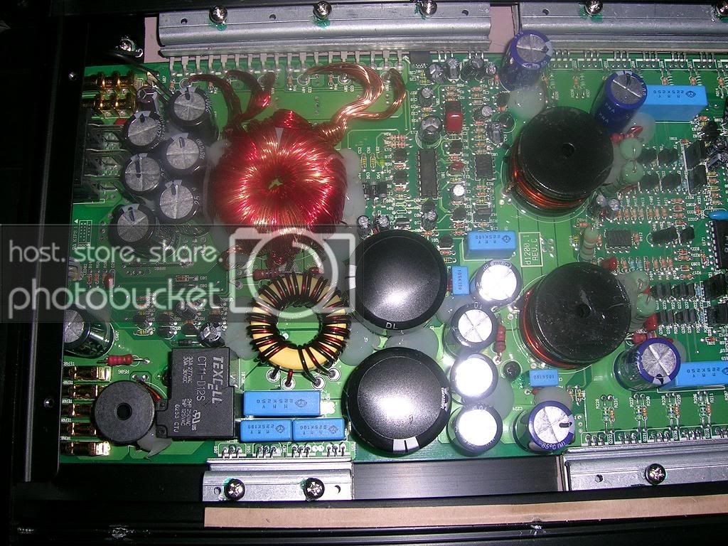

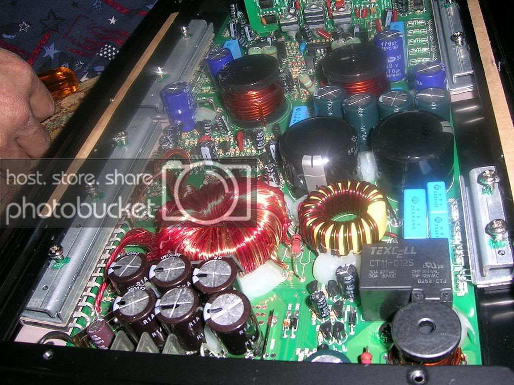

Here are some pics of the guts on the Viper 1200, maybe some of you amp experts can find something wrong.
..what the hell is wrong with my amp guys
Same thing happened to my Viper. The first time it played fine then the amp was so hot that I could barely touch it and it was only wired to 2 ohms. Then everytime after that when I would turn the amp on the would constantly switch from protection to power with this clicking noise. I ended up getting rid of mine. I did a search on the forum and others had this problem too and people said the amp was blown. I know mine was a refurb from Ike and the amps in the other post I found were also refurbs from Ike. By the time I installed my amp the warranty had expired so I was fvcked. This time around I'm getting a brand new amp, I'm not messing with the refurbs anymore.
