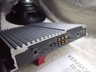

I have attached a pic of a 4 channel amp with crossover settings so you can cross your front speakers at 100hz and your subwoofer will produce frequencies below 100hz.  By applying high pass filter to your front speakers will make them sound more louder and accurate when the volume is turned up.
