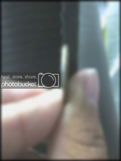

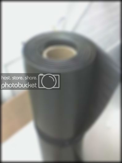

Something else I have used that is very effective, while a little unconventional, is rubber carpet runner. Im not talking about your normal carpet runner with holes in it. There is a kind that is a solid VERY dense rubbery foam material. The problem is the only time I have seen it (I bought the whole roll from lowes) it was a little too thick for use in cars where stuff has to fit down over it (although it does compress a good bit.
here is what I found; just need something a little thinner:
Oh yea, I think I payed $30 for this whole roll (at least 30sq feet)
