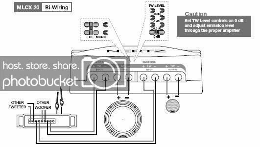

I have a boston gt-42 (4x75w 4ohm or +- 220w 2 chan. bridged 4ohm i think?) and ready to fit the 2 way compo hertz mlk-165. They would go to the passive crossover (bi-wire capable) supplied in the kit.
Which would be the preferable scenario (objective SQ):
1 - bi-wire all channels to each mid and tweeter outputs from crossovers, as per
in which i would probably still have 75w per channel, or;
2 - bridge the amp at its outs, so just 1 pair of wires gos into the crossovers, but with higher power
Also in bi-wiring, and because the scheme puts the attenuation at 0db stating to control from amp, isnt this like going half-active or something? alpine 9887R has its own low/band/high active crossovers.
So which scenario i would get a better SQ, with bi-wiring/lower power, or regular single wiring but higher watts?

If bi-wiring is available as an option, try that. Even if just temp wires across the car, give it a whirl. I'd do a general HP and LP on the amp so it doesn't work as hard to send wasted engery, which winds up as heat, to the crossovers.

I agree with Andy.
Unless you absolutely need the separate level control (in which case you should just go active anyway), I'd take the 220w per side bridged over bi-amping any day.

The sep level control is exactly why I'd bi-wire. //content.invisioncic.com/y282845/emoticons/fyi.gif.9f1f679348da7204ce960cfc74bca8e0.gif

well, because i will have the cars guts taken out, i might try going active on the wires, and give my ears a bit of judgement.!
Probably i would have to be extra careful at setting the 9887R head unit active mode and crossover points at anything near according to the manufacturer. According to Hertz, if i use the large chamber option mounting on the tweeter (i intend to),
the tweeter high pass advised is anywhere from 1800Hz to 5000Hz, and the resp.frequency is lowered from 1300Hz to 950Hz (i´d prefer the smoothness with lower Queue)
in the specs the mid driver hertz ml 165 has a response freq. from 35Hz to 25kHz, i could low pass it to 80Hz so to get the rest to the subwoofer.
i might really try to go active.! it´s just a shame to let go a brand new pair of hertz crossovers lolol but if the alpine HU can handle it, why use them anyway..
what do you think of that?

adding to that, on an active setup should the control be given full to the alpine head unit, thus disconecting all the filters from the external amp, or is it that a full active setup has no external amp/amp crossovers, coming all just from the head unit.?

i run xovers on my amp and run all the filters . seems good to me and i get the power to speakers
Bi-wiring and Bi-amping are two very different things. //content.invisioncic.com/y282845/emoticons/fyi.gif.9f1f679348da7204ce960cfc74bca8e0.gif
If you have the means to do so, go active over bi-amping.
