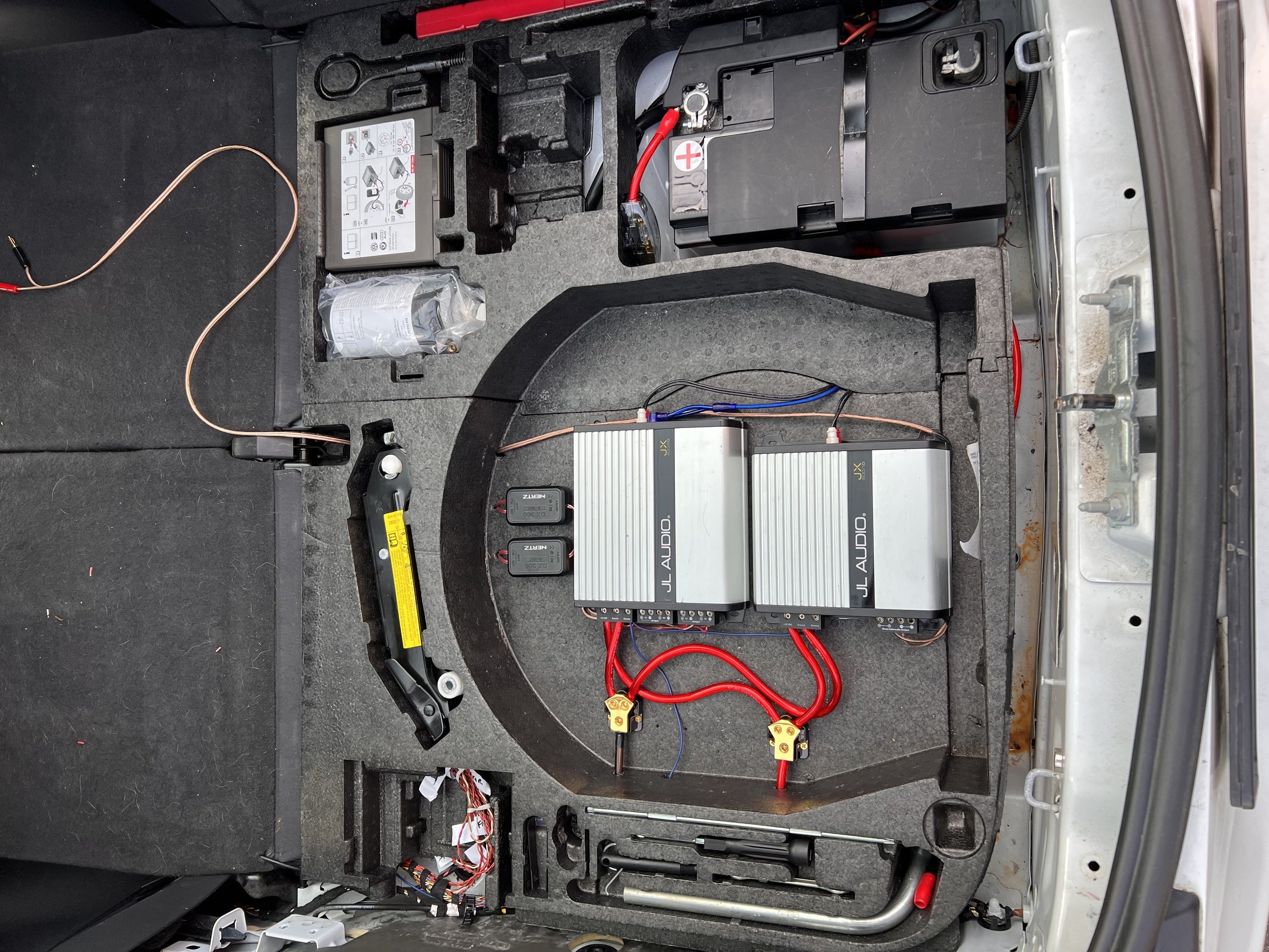

The amps are in the boot/trunk on the thick foam/polystyrene insert that comes with the TT. I’ll include a picture, but I must mention, I didn’t have enough brown cable for the ground, so it’s brown to the distribution box then red to the amps (I figured the amps don’t know what colour the insulation is)

Nice layout. But sometimes noise can come from the oddest places. Does it do it with the stereo off? Radiated noise problems can effect the speaker wires themselves. I have seen a tweeter with a speaker wire connected to it be noisy, even though it was not connected to anything.
