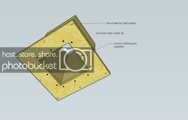

interchangeable port
this is a crude sketch but you get the idea
Just make sure to use threaded inserts to mount the port wall other wise after only a few changes the holes for the wool screws are going to get worn out and you wont be able to us them any more
