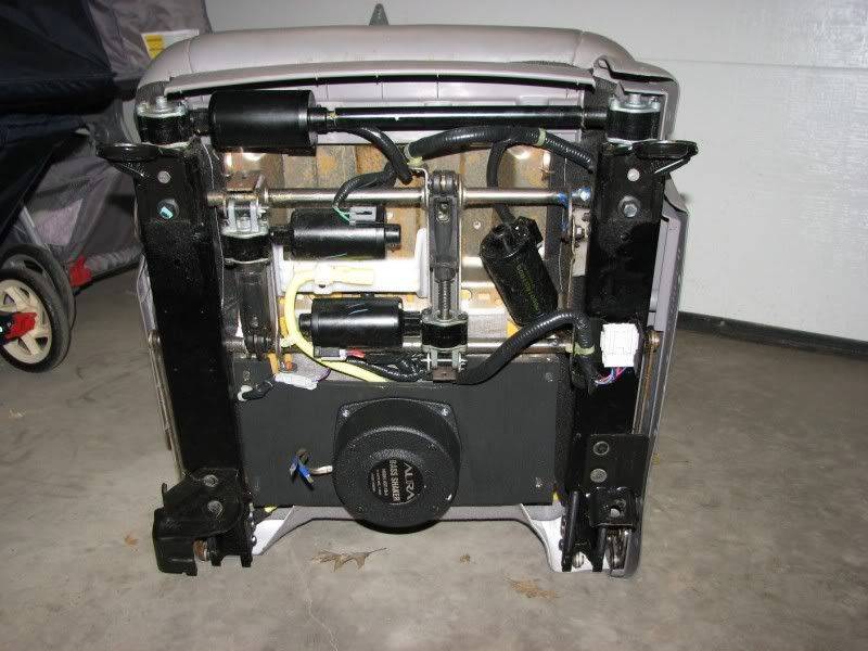

i had to search through hundreds of saved photos and many folders to find this pic. but i knew i had it. i just secured a wood board to the seat where it made sense, and secured the shaker to the board.
my impressons of bass shakers are they give the illusion of very tight, accurate bass since there are not phase issues or delay to worry about. they are kind of neat. and they do it very efficiently. that said, i sold these.
the key is rigid mounting. nothing soft or pliable. nothing that is easly bent. you want to efficiently transfer the vibration into the seat frame.
