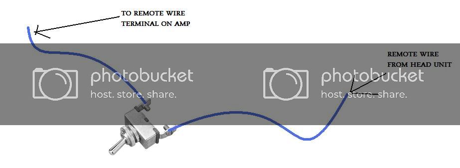

lets make this simple, i think everyone here is confused. If all you want to do is to be able to turn off your sub amp, then put a toggle switch inline with your REMOTE wire. I did this in my car and just cut the remote wire and put a toggle switch inline.
I bought the cheap simple silver toggle switch at walmart for like $2.99 and it only has 2 places to attach wires to, and uses little bolts to connect the wires to. easiest possible way to do it and it works perfectly.
The toggle switch he bought has a build in LED. The ground terminal is for the LED, and it draws power from the source (supply).
Supply -- remote wire from head unit.
Earth -- Ground anywhere, closest to where you're mounting the switch is the easiest.
Load -- Wire from the switch to your amp's remote input.
