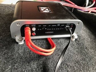

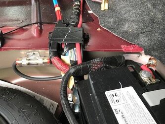

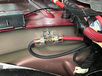

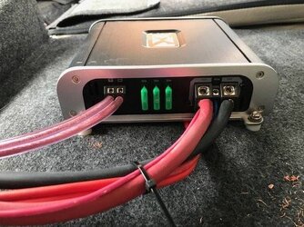

I installed the amp on the back of the seat.  I'm not 100% sure I love that, but we'll see.  I put nylon spacers under the amp to provide air flow under the amp to hopefully help with cooling.  I feel like the power connections to the amp are a little flimsy, but seems to be OK.  I used 100% copper 4 gauge wire for the power and ground.  Battery is in the trunk so this install was really easy from that stand point.  The inline fuse is a 90A.  I think I covered all the bases.  Everything works, no sparks or fire.  There is a post in the box construction forum that covers the building of the box in more detail.
