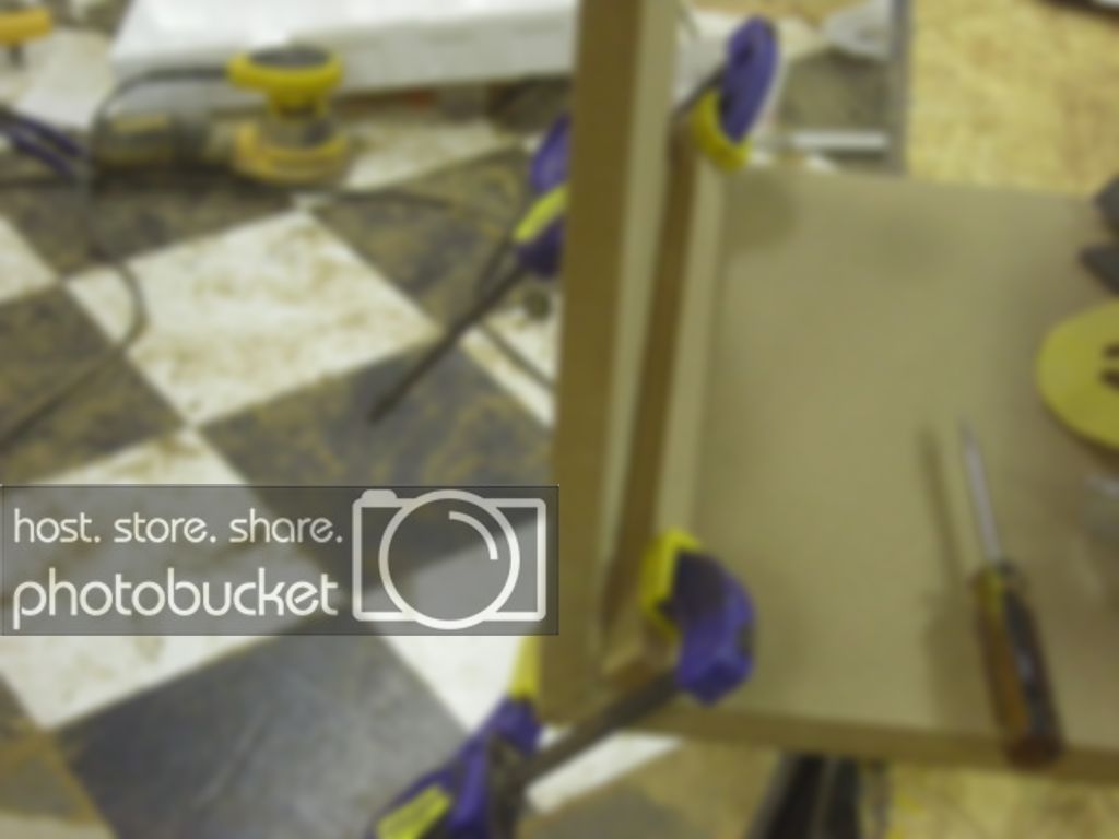

Take a normal piece of mdf cut to the height that you need the 45 insert to be...then tilt the blade of the table saw 45 degrees and move the fence so that the outside (left side) of the blade will just reach the top corner of the mdf...this will leave a 3/4"x3/4" piece that's 45 degrees (assuming you have a left-tilt table saw at hand)
