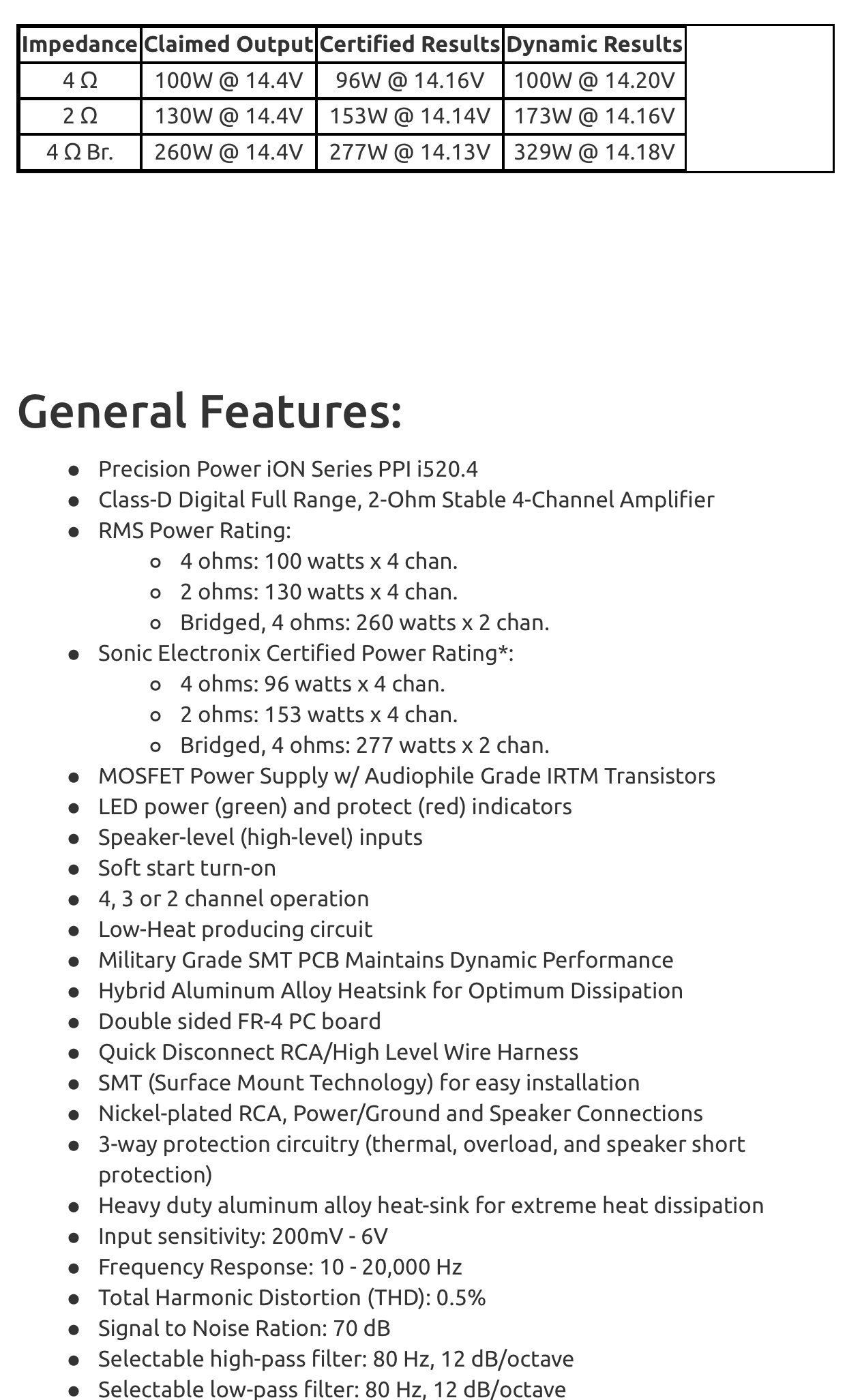

I’ve been searching high and low and just can’t find answers. I have 2 pairs of infinity kappa coax speakers in the door and they are rated at 2.7 ohm, I also have 4 tweeter that are rated at 4 ohm, unfortunately I have to use the factory wire which combines both speakers and shows my amp a final impedance of something around 1.4ohm and is causing my amp to get incredibly hot. What are my options besides wiring the tweeters independently from the the kappa’s
