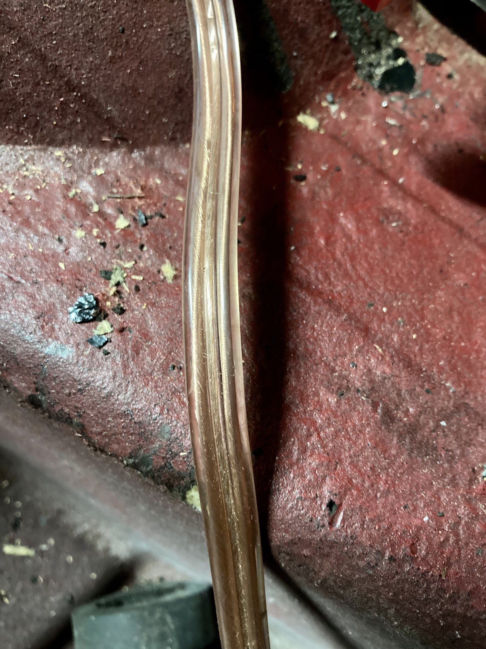

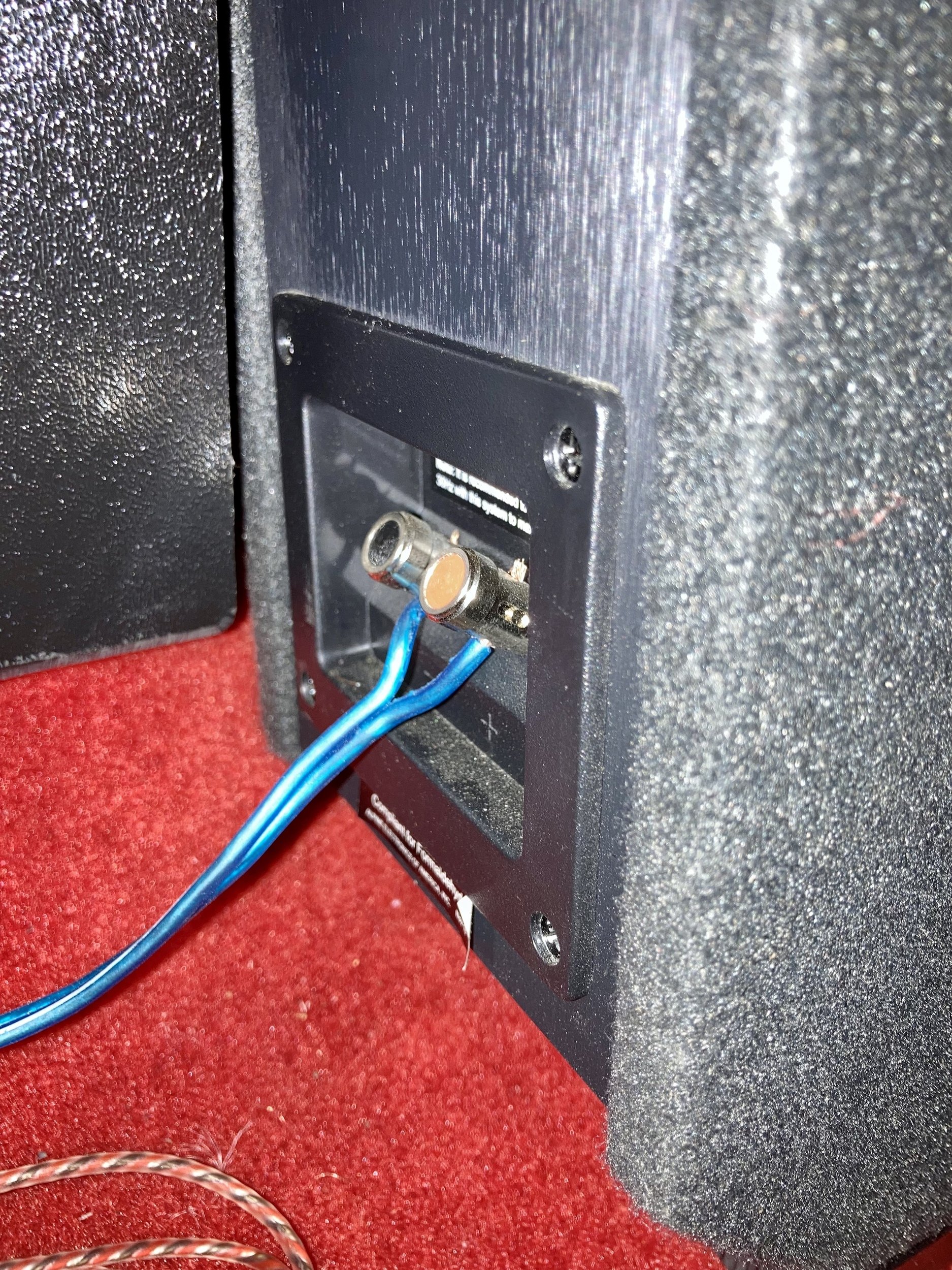

This is the wire that was chewed. I traced it back to a second amp that powers the sub-woofer, So I’m told. The other picture is of the two wires to the sub- woofer that are visible.
I don’t understand why the wires in the two pictures are different unless the sub-woofer has additional wires that aren’t visible.

I'm fairly sure that first picture is a set of RCA cables
They should run from the HU to the amp
It what carries the signal to the amp
If they were chewed on then and then repaired it would explain the feedback your getting through the speakers
When you disconnected the remote wire you cut the power to the amp and stopped it
If they look anything like the picture I have posted then that is your problem
Just replace them
It will cost you $30-40 for a decent set of cables and if you have them installed somewhere probably about an hour of labour or you can do it yourself if you feel up to it
