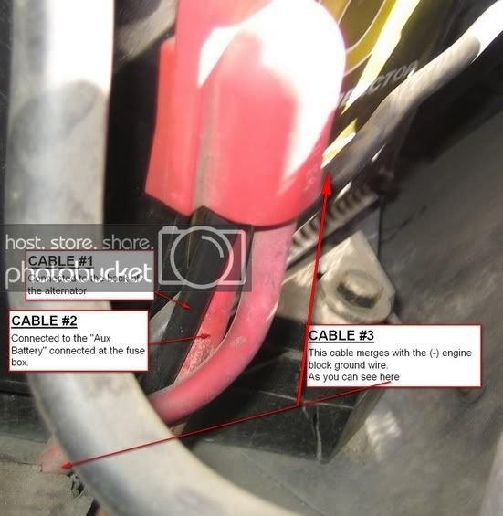

I'm in the process of doing the BIG 3 in my 2000 Z28 Camaro with 1 AWG, but now I'm stumped.
I understand the BIG 3 as being:
BIG 3 =
Alternator to battery (+)
Engine block ground to battery (-)
Chassis ground to battery (-)
However, when I went to the positive terminal, I found more cables than I expected.
CABLE #1: Being one of the BIG 3, I expected to see.
I wasn't expecting to see CABLE #1 and CABLE #2.
What are their functions?
When doing the BIG 3, do I need to replace all of them? Wouldn't that make it the BIG 5?
Thanks,
Joel
I'm thinking about buying extended bolts for the side posts.
For the (+) side
-I'll use the factory (+) ring terminal and just cut off the wire that I'm replacing(CABLE #1) and replace it with 1 AWG.
-I will then hook up the new cable directly to the new bolt.
For the (-) side
-I'll toss the factory ring terminal and hook both grounds directly to the new bolt
That way, I'll leave the other wires alone.
What do you guys think?
Thanks,
Joel
