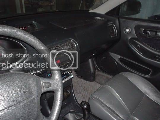

i found someone on craiglist giving away free door panels that fit my car. its an ugly color but im thinking about picking them up to maybe practice fiberglassing or something.. juding from the picture below, what do u guys suggest i try doing? im skeptic about door pods working because the midwoofer area protrudes so much already, i dont want a funkylooking door panel and i think the front seat passsengers will block them.. but what do u guys think?
what should i do since the door panels in my car are covered in vinyl? should i take off the speaker grill and somehow seal the hole off and then build a pod over where the speaker grill use to be?
Depends on what the panel itself is made of . If it plastic or hard board , you can pull the vinyl off. Scratch up the areas you want the glass to attach. Then use epoxy resin. It sticks to plastic better. Can also drill some small holes in the plastic where your going to attach the pods. It will give some teeth for the glass to hold to the plastic. I would remove the speaker grill , but don't worry about sealing the hole . Just mount your rings over top of it angled the way you want //content.invisioncic.com/y282845/emoticons/smile.gif.1ebc41e1811405b213edfc4622c41e27.gif
