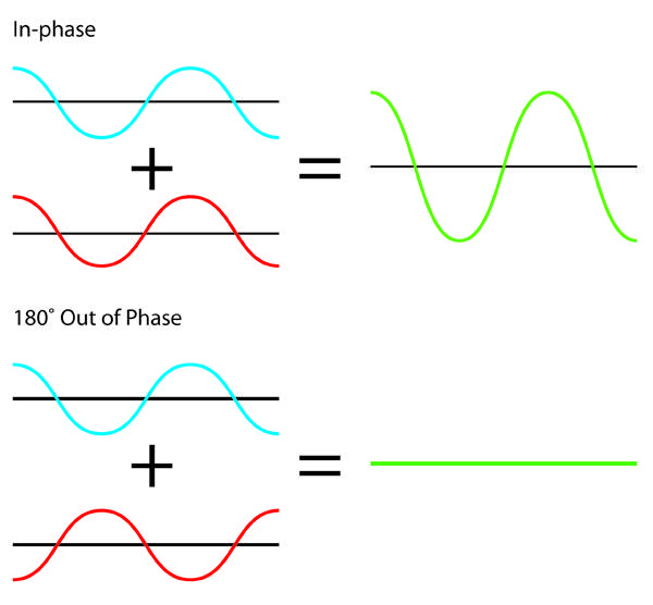

You may be getting cancellation because of having two different boxes with different responses. There's a good picture I'll post showimg what I mean when I get on my laptop
