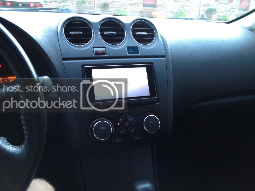

I did a full install of the older Pioneer AppRadio with backup cam, bluetooth mic, nav antenna, iPhone/iPod cables, steering wheel controls module, and manual parking brake bypass switch:

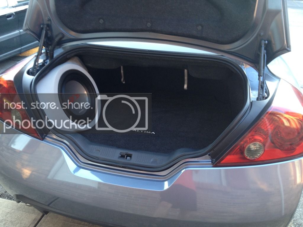

Next I started this big custom corner box project and installed a Kenwood 500x1 mono amp wired at 2ohms to a 3rd gen Alpine Type R 12" sub:
