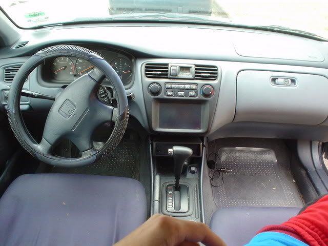

ok i just spent about an hour testing and listening testing and listening testing and listening. i listened to a variety of songs and a pink noise track(which btw yours get fatigued real fast after a while when there is no eq done to horns) . I got it veer left and right but it just wont budge up //content.invisioncic.com/y282845/emoticons/frown.gif.a3531fa0534503350665a1e957861287.gif
These horns are getting me upset. I have to spend an extra couple hundreds just so i could "cheat" by going 4way.

Hmm, so aim them up some?
only way i could do that is lower the horn and raise the lense. this will get in the way of driving :/
only thing i can think of is bringing the whole horn forward to dash edge...
