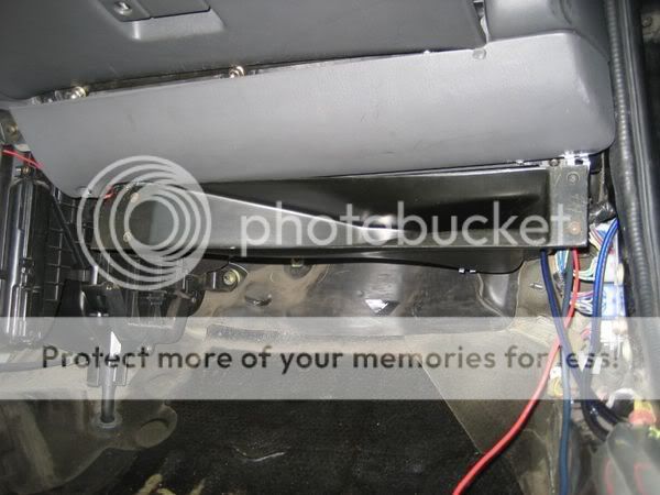

See you have your horns more up front. mine will be further deeper back, and i dont see anything i could mount to. the only option i can do is create a small "rack" for it and mount it to that. that motor is heavy is what i am really worried about, i want it sturdy.
Yes I saw the pics of your dash. No I cant tell you how to mount your horns just by looking at them. //content.invisioncic.com/y282845/emoticons/wink.gif.608e3ea05f1a9f98611af0861652f8fb.gif
Many people actually weld brackets under the dash to hold their horns.
what I also did was have a metal strap connected to a screw (that holds the horn motor to the body), bolted to the firewall.
i'll try to get pics.
OK I mounted the horns today. they are ghetto installed for right now so i could hear them. the passenger side i installed pretty correctly with plumbers strap. the driver side i didn't have enough strap left over so i had to use zip ties, i used a ton for that side.
