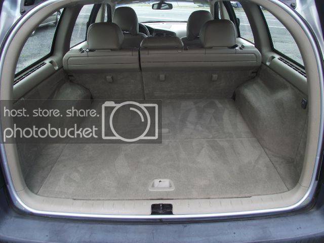

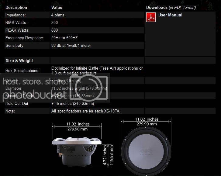

Hi names Dean, I currently own a 2002 Volvo XC70 wagon, i recently blew my XFL1544 because I'm an idiot. Shortly after I received a Wet Sounds XS-10FA for free because the spider became unglued. I have a SoundQubed Q1.1200 I'll be powering it with @ 4 ohms (set with a dmm to 300 watts) and with my gain knob unplugged, because gain knobs and impressed passengers don't mix lol. But anyways the sub calls for an Infinite baffle or a 1.3 cubic foot box. I just wanted opinions on what i should do here's the specs and I'll try to get some pics up of my trunk in the morning. Thanks, Dean.
Not mine but same year and a better pic then I would've taken with my phone.
you have no infinate baffle to baffle with there.
infinate baffle can be done if you put up a wall directly behind your second row seating and completely sealed it off allowing the entire rear of the car to be isolated airspace and the infinite portion of the term infinate baffle.
if your car had a trunk - you could use the rear deck to mount it - and allow the entire space of the trunk to be infinate baffle / or more commonly now adays refered to as trunk baffle.
the most important part of this configuration is to absolutely definately completely isolate the front sound wave from the rear sound wave of the sub because the rear wave will cancel out the front wave - to achieve this infinate baffle configuration in a viechle you need to seal up every hole / gap / or any place where the rear wave can escape to the front.
so in your case
sealed box
but i also dont see why that sub would not perform nicely in a ported enclosure
@brian84corvette Yeah I didn't know if something could be built in to the floor, I'm a noob when it comes to this stuff. Since there's no info on ported enclosures on their website I'm kinda lost, would you have any recommendations on size or tuning I use Torres box calculator quite a bit, but have had a little trouble figuring out WinISD.
