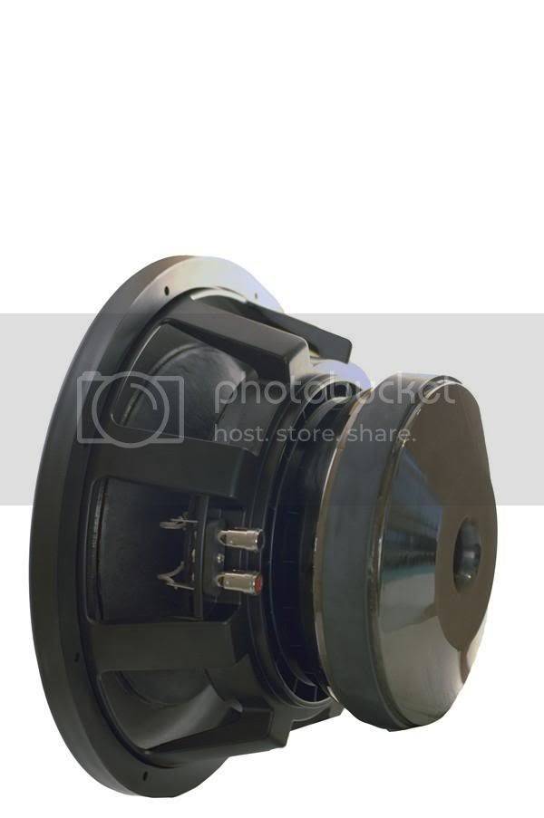

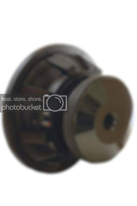

Yes, it is underhung. The tell-tale signs are the tall top plate vs the short stack and back-plate. It's not deep enough for the coil to hang over the gap and have much travel, so it must be a short coil travelling within the gap.
Plus, IA publishes that it is. //content.invisioncic.com/y282845/emoticons/smile.gif.1ebc41e1811405b213edfc4622c41e27.gif

True, XBL subs look the same but I should have known it wasn't XBL.
