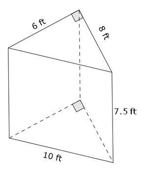

A 45 in the corner of a box? Think of the volume as a triangular prism. Find the area of the triangle (1/2 the base x the "height"), then multiply by the height of your enclosure. If you measured in inches, then yes divide by 1,728 to get cubic feet
yea corner 45s... what do you mean base?
