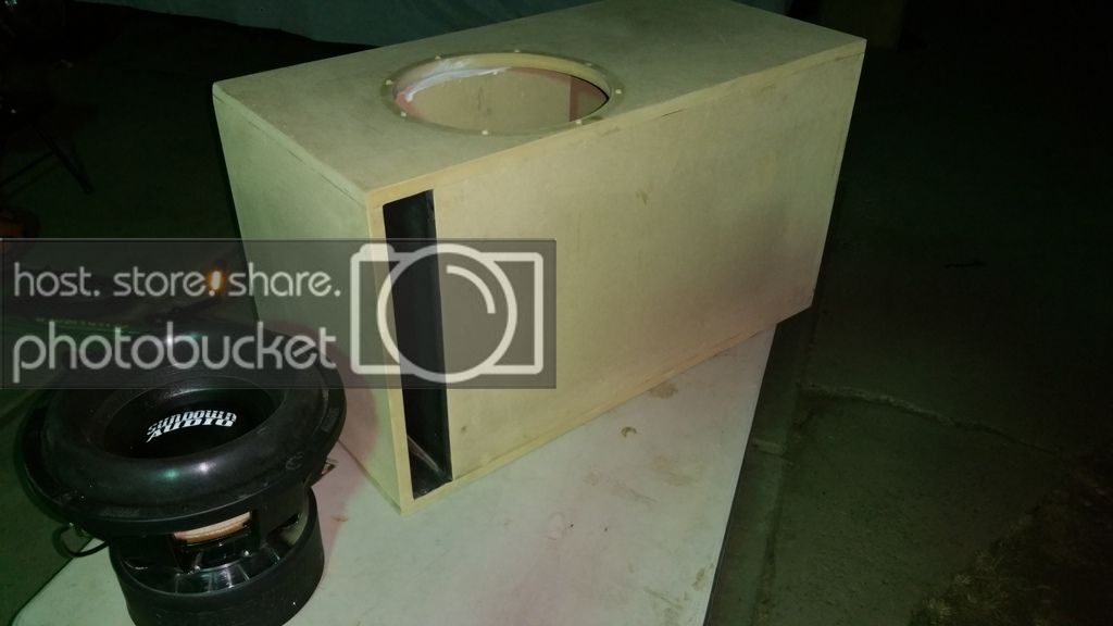

I need some help.please
33x16x18.5 external
Port is 40 square inch, 33 inches.
Which puts me at like 26 hz but not counting the woofer displacement.
I messed up... my math has failed me. Was shooting for 3 cubes at 32 hz. Box is too big, port is too long. Should I just add some 2x4 bracing inside and see how it sounds? What would you do? Start over?
Would you double baffle?
It's an X12 on an Alpine 1005. Amp will be upgraded soon.
It sounds decent but my original box moves more air. It's 2.5 @ 32 using the sundown site recommended box specs. Ya it's an x12

Any time. Holler if you ever want a demo. I'm up for a road trip south.
Shoot, Id love to hear what 2 8's could do in a Tline!
Wifey wont be too happy about this but Im off to buy another sheet. 3rd box in 3 days. Hopefully got this one right.
32x16x16.5
2.5 net
Port:
41.25 sqin
2.75x15x40
Cut sheet:
Top and bottom: 32x16
Sides 15x16
Front 15x27.75
Back 15x30.5
Port side 15x11.75
Port back 15x24.25
Would you do sub up, port back?
Its a Scion xB
These dimensions leaves about 8 inches from box to rear trunk wall.
