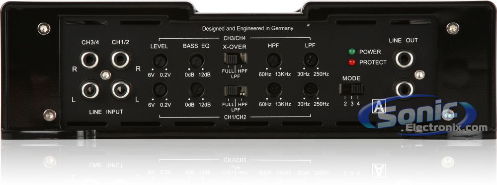

I dont even think the onyx 4.125 has a gain control. I dont see it anywhere
FAIL.
do you not have eyes?
its marked LEVEL, its to the left of the BASS EQ KNOB.

haha my bad thats why. I quickly glanced for the "gain" and skipped right over "level" yea im an idiot. I cant believe i did that. anyways...... I have a dmm and I know there are stickies to make sure ur gains are set correctly with it. (oscope is obvsly better but i dont have one). So how am I gonna get this thing to push 100 watts instead of the 125 is the real question.
