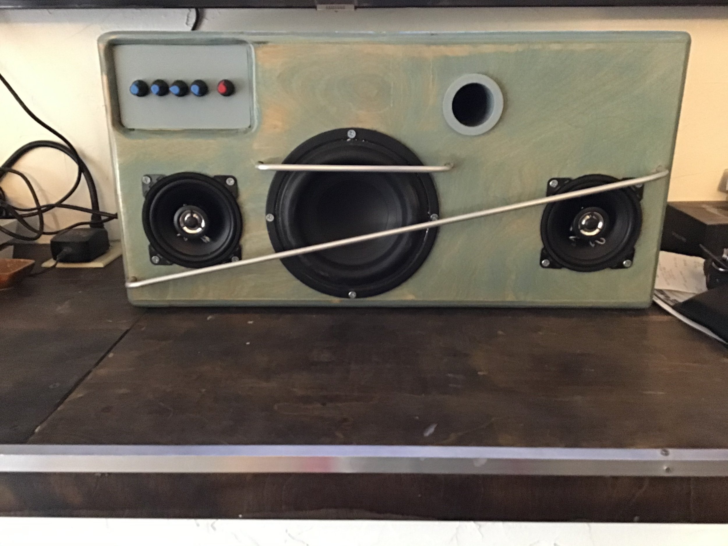

I use the tpa3116d2 amp boards for home bluetooth builds often. They put out 25 watts x 2 and 50 watts x1 rms power. Some of them come in cases, like what you posted, but you can buy them with the board only also, which is what I use (so I can mount them inside an enclosure to have an all-in-one stereo).
I just built this one a couple of weeks ago using the tps3116d2, with some added potentiometers and volume controls on it.
Technically, the volume knob is the gain on these. On mine, I have 3 volume knobs. A satellite speaker volume knob, a sub volume knob, and a master volume knob. The other 2 are crossover adjustments for the sub and satellite speakers. I’m not sure how yours is set up.

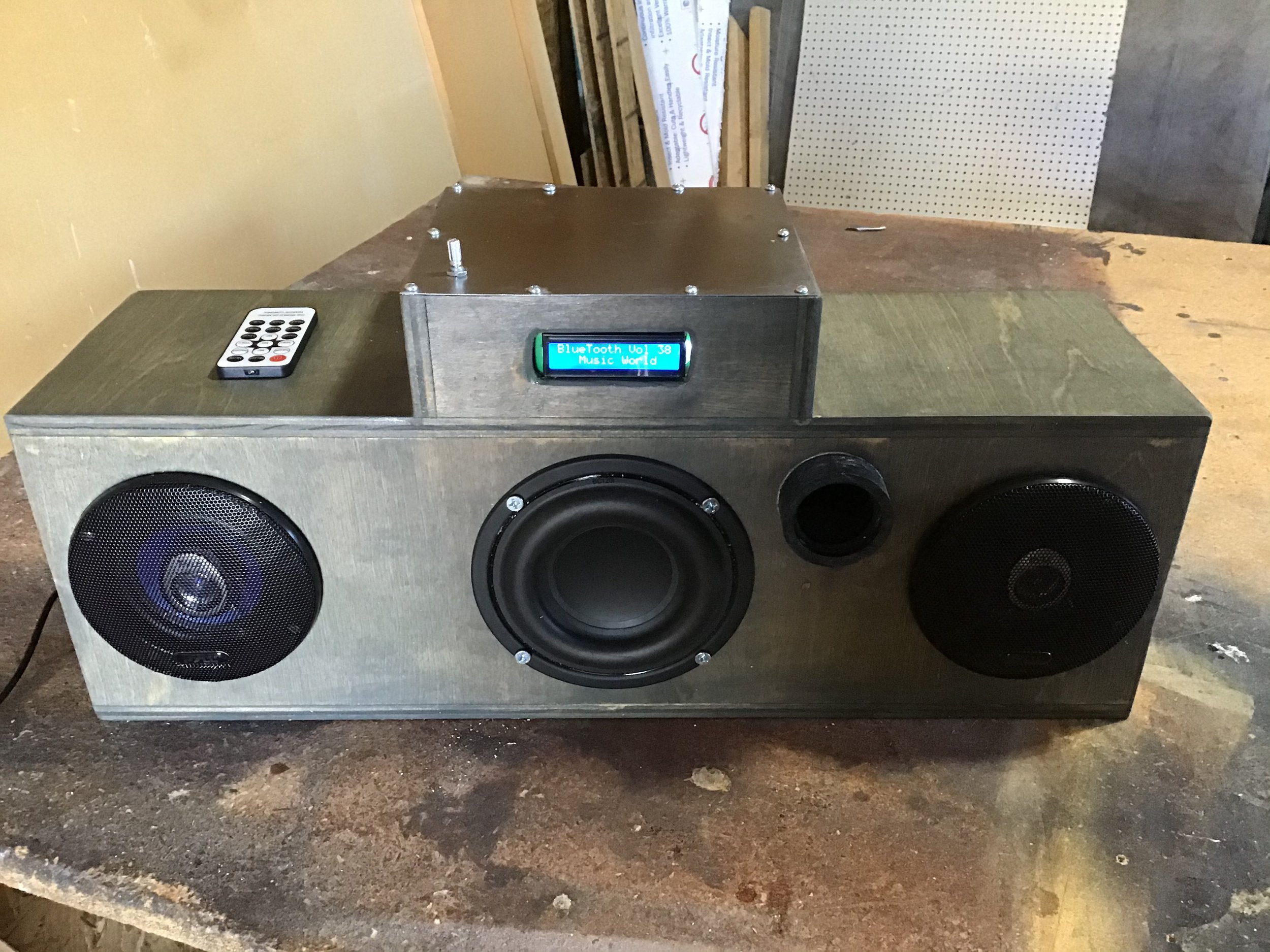

This is my shop radio, using the same amp board but with a digital screen instead of physical knobs. Regardless of the features that come on these, they all put out 25 watts x 2 and 50 watts to the sub channel.
