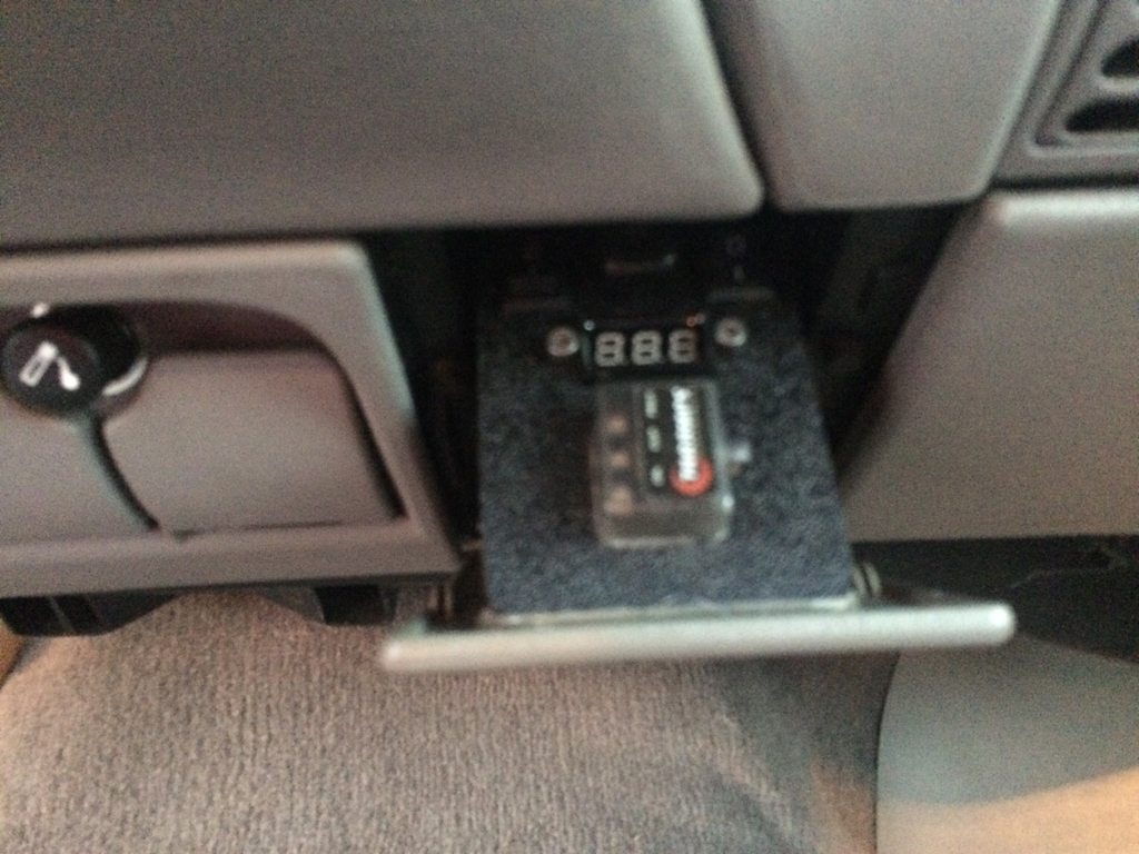

I have one in ashtray with clip indicator for taramps and a switch so I can turn on and off stereo alts but that one in rear is a smart meter that is programable to shut down amps at a set high voltage and a set low voltage and it just happens to have a voltmeter too

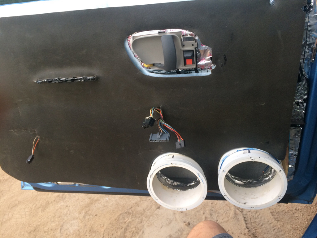

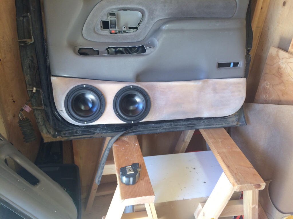

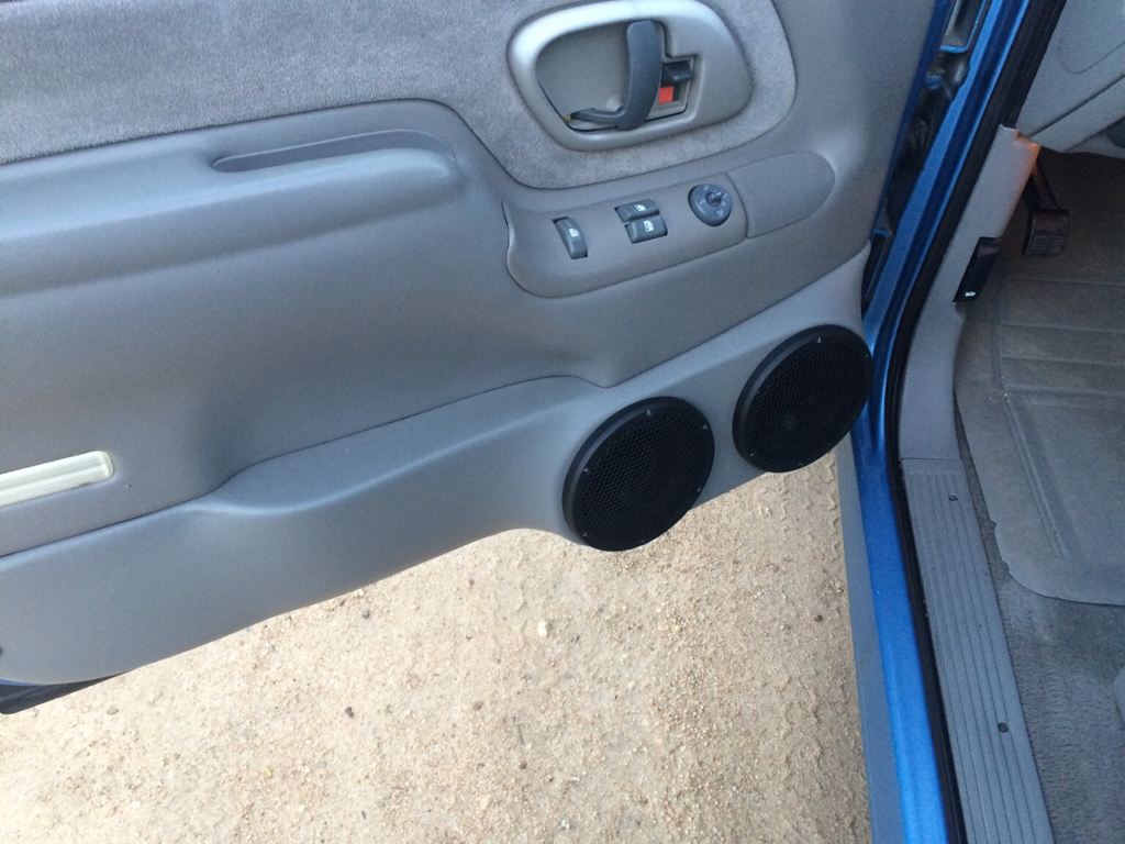

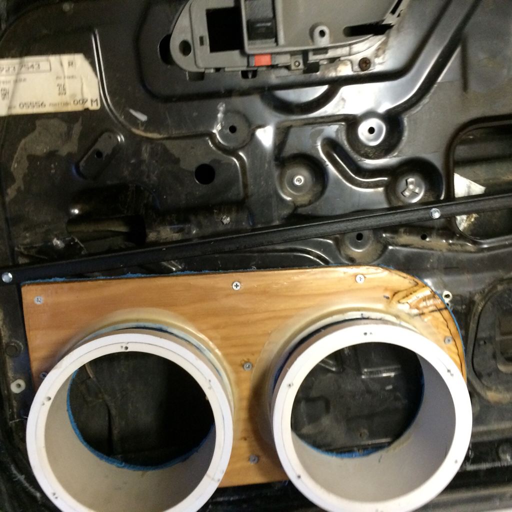

Ya I think so as it makes it semi sealed into the doors completely sealing off back waves and makes them very strong mounts too . I also completely deaden the the door skins inside and out and then used fiberglass panels incased in sheet plastic (ceiling tile) on the whole inside door skin to help cancel back waves then cover outside of door with CCf foam and Mlv under door panel so my mid bass rocks lol , it was a lot of work but worth it in the end. Also I went and bought another door so I could work on my workbench instead of trying to work on doors on the truck until I had it all figured out and pre made everything.
Yes 6" pvc sch 40 and cut a 6" coupler to make a ring for mounting flange and it worked out perfect then I glued and pipe into plywood with construction adhesive
