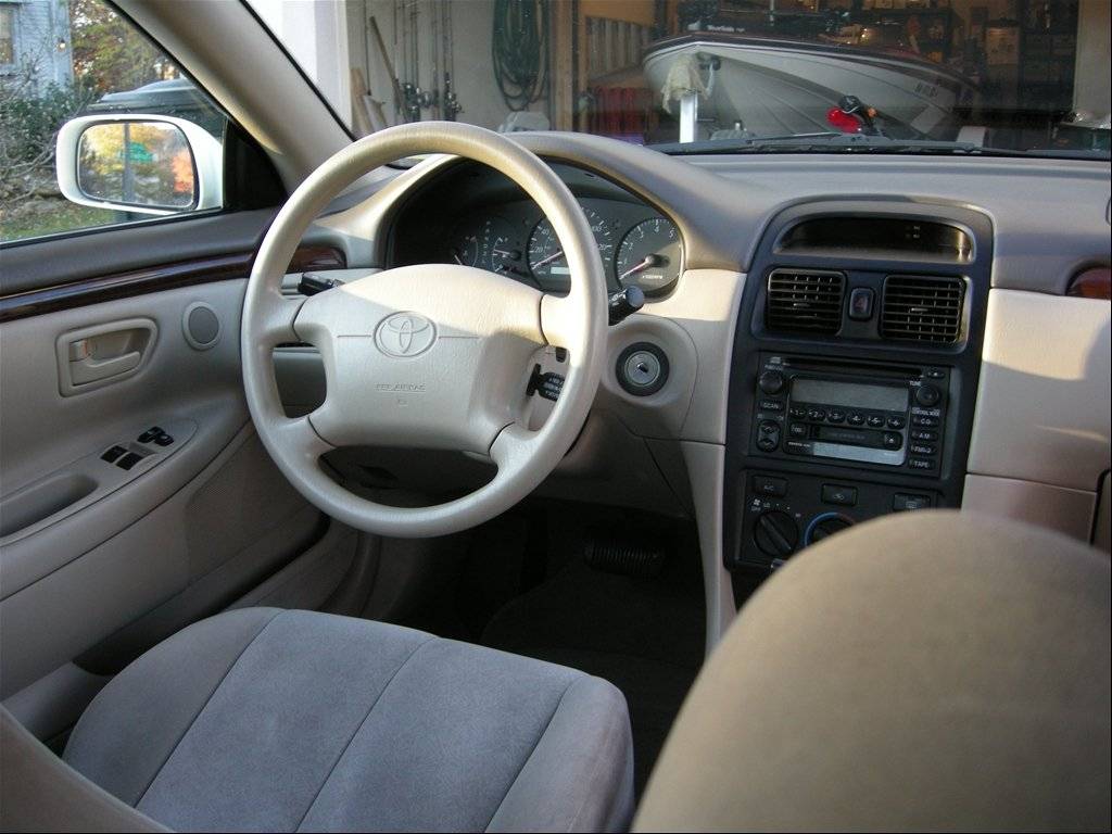

The mids and tweets are currently mounted in the stock locations. Doors have been deadened with raammat on inner and outer doors skins, and mids are mounted on MDF rings with clay used as a vibration isolator between speaker/ring and ring/door. Here is a picture of the factory locations.

so it's a 99-01 Camry? i own an 02 Camry and had a 98 Camry - and it looks to be between those years.
i never liked that tweeter location on a car. so i never reuse it.
