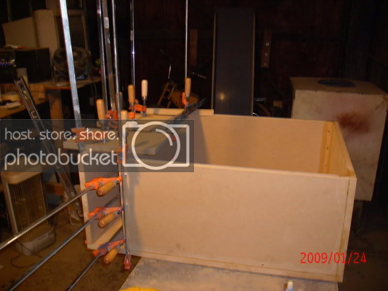

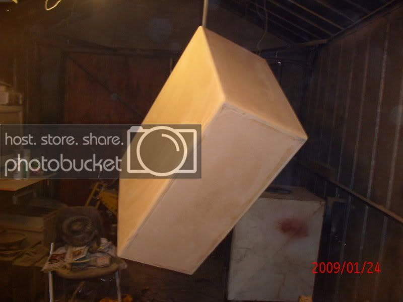

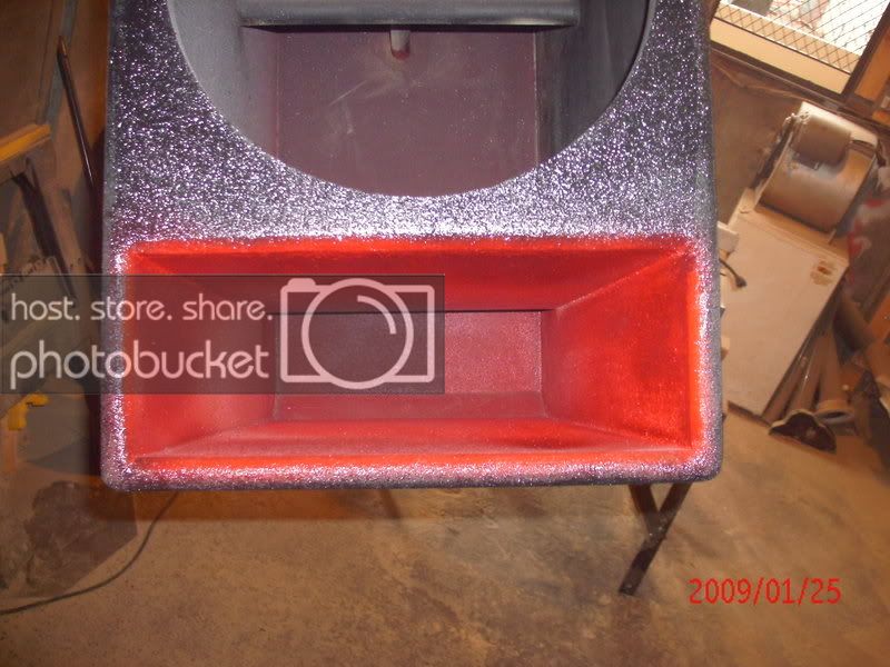

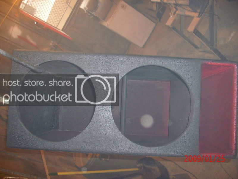

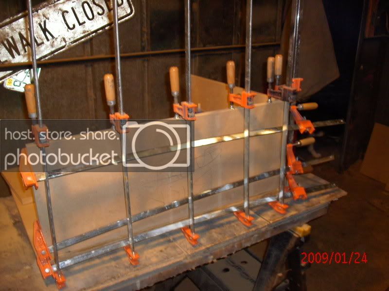

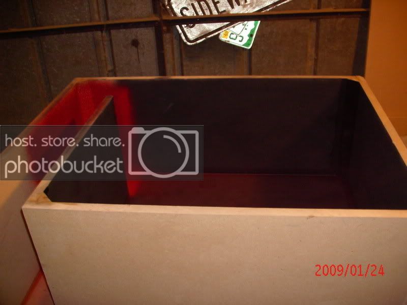

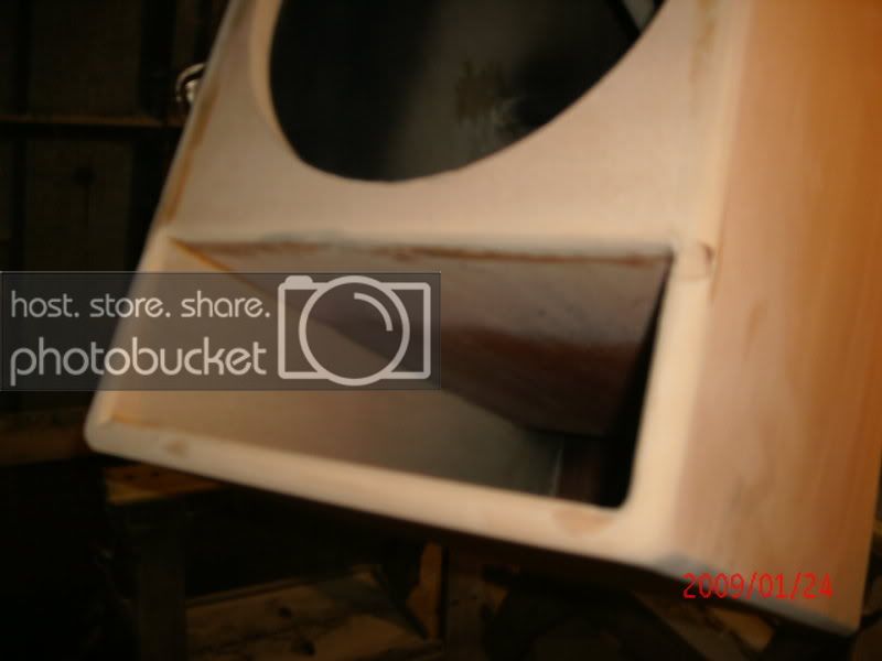

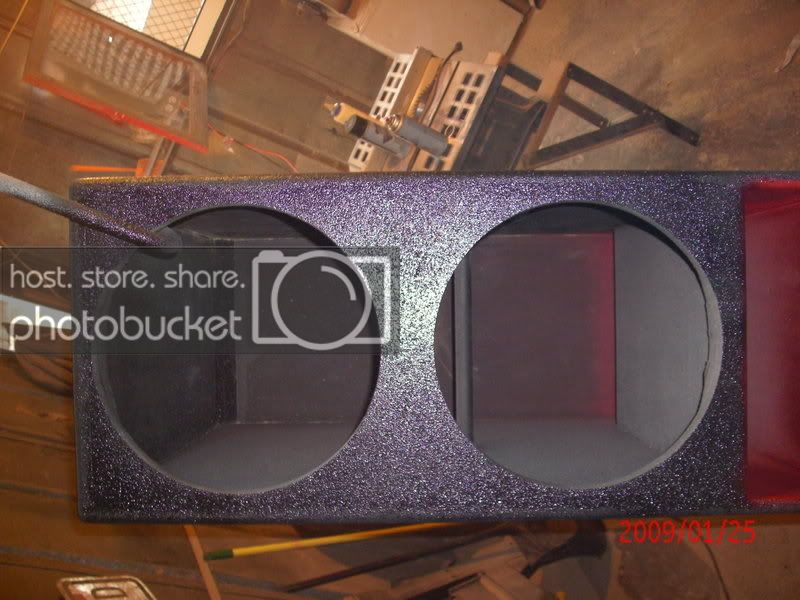

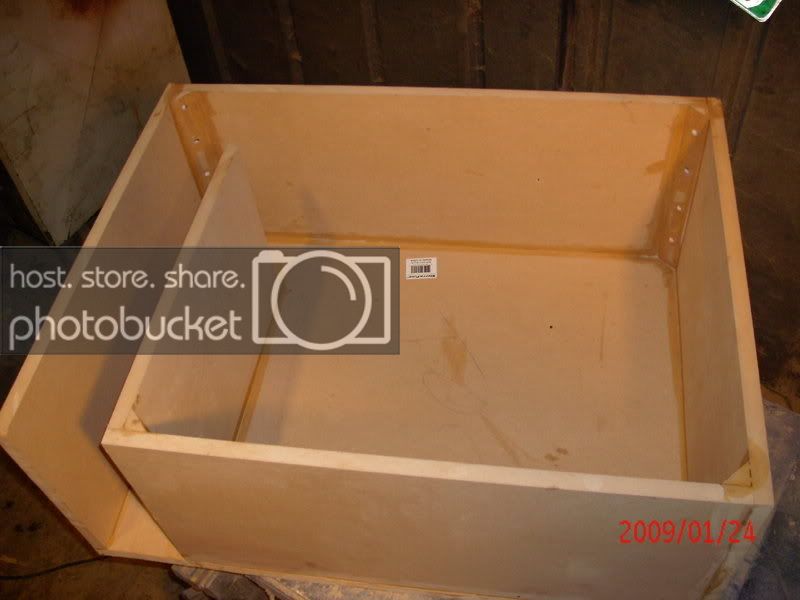

goes in a honda. trunk unseen. hope it fits:crap:3.8 cubes tuned to 35hz

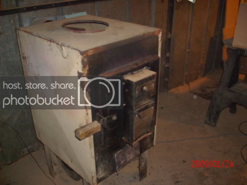

40,000 BTU's. almost free. just costs gas to get the wood.

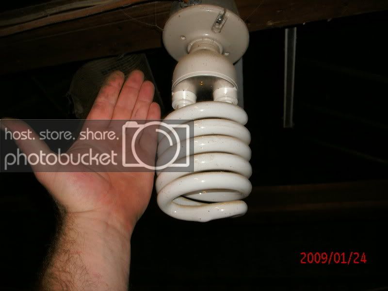

giant compact flourescent. 300 watts worth of incadescant light, but only 60 watts of energy used.
nice work, should fit fine if that is a 12 box
actually, it goes in the same car you have, only 1 year newer. it is 31.5 wide. 13.5 high. 24 front to back. i never saw the car. i did it by his measurements. he's driving up to get it in a couple of hours. i'll shit if it doesn't fit.
