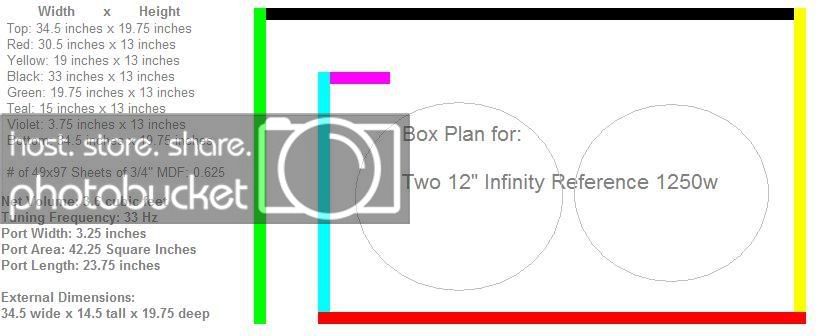

How's this box plan look?
o6blink
Dave
Got it from pboulos, hes been helpin me out a bunch. Opinions? Good? Bad? Why?
Anybody? I'm planning on getting this cut today at home depot if nobody speaks up! //content.invisioncic.com/y282845/emoticons/yumyum.gif.0556df42231b304b9c995aefd13928a8.gif
Infinities wouldn't be my first choice for ported speakers and remember they are very fickle speakers..
Even the slightest bit of over powering them is a No no..
but what would I know...
//content.invisioncic.com/y282845/emoticons/smile.gif.1ebc41e1811405b213edfc4622c41e27.gif
that subwoofer designing calculator is a little off. I designed a 3.5 cubic box on there at 33hz, and it actually came out to around 3.7 at 30hz. just a heads up
what programe did u use to compair it with, i find that non one program is consistant with another
That will give you a close to accurate design, the only reason it is off is due to rounding to suite "standard" dimentions.
IE you will get a depth of 12.75 instead od 12.563222 which in turn with increase your net volume and raise the tuning freq.
It is right on for port lenght based on gross volume and height given.
The only way your going to be completely accurate is to calc the stuff yourself, thats what I built my own calc;)
