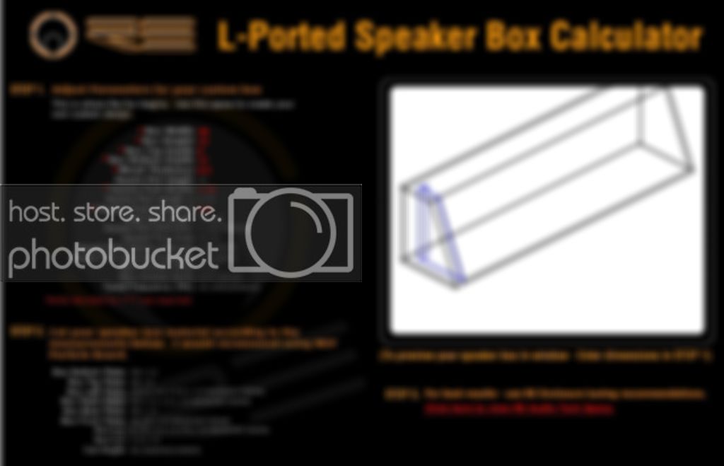

Audiobaun, I went out and measured my truck, and plugged the available space into the box calc that RE offers on their website. How does this look to you?
