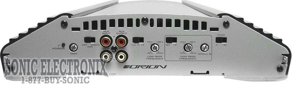

I'm trying to figure out how I need to run my 2 Orion 2500D's to a single DVC. I know I cant strap the amps, but I can have one master and other copy so there is no need to gain match. I'm just a little sketchy on how to do that. The guide said something about remote gain.
Also how would I determine that both amps are providing equal power to per coil (how important is that) ?
If it is like this, the 1st amp will be set to MASTER and the next will be set to COPY set the gains and x-overs on the MASTER amp and turn the gain to 0 and the x-over off on the COPY amp.
When the switch is in the MASTER position, the RCA outputs are buffered through the gain
stage of the amplifier and filtered through the crossover sections of the amplifier. When set
this way, the amplifier's gain and crossover settings are sent to other amplifiers down the signal
chain. This can be useful for configuring multiple subwoofer amplifiers easily in a large
SPL system. All subsequent amplifiers after the master amp will be in the COPY position and
have their gains set to zero and all crossovers turned off. The master amplifier will control
all the functions of the slave amps via the MASTER RCA output signal.
...from this: http://www.directed.com/guides/manuals/og/orion/G47395.400.405.410_11-04.pdf
