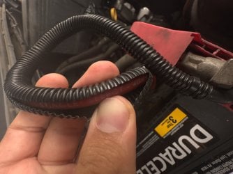

You should post pictures of what's done.

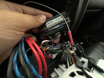

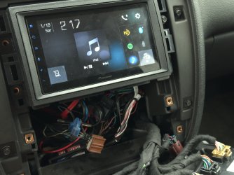

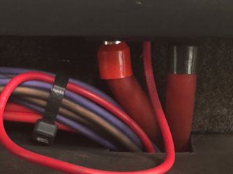

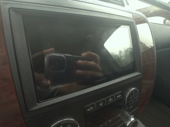

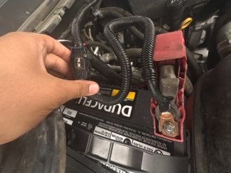

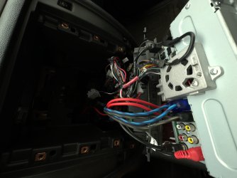

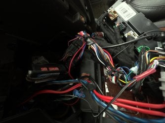

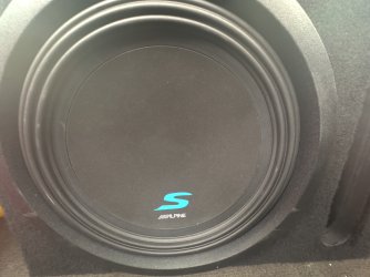

Here are the pictures, sorry i am on 30 KBPS internet, took a little to upload and download

The speakers are wired with the

Green and Yellow wiring. Me and the other installers installed it, and for the speakers there was a what i remember to be a yellow wire with green stripe, and a yellow wire with possibly green. I had them tune the amp and the head unit about 3 times, and its still clips out on bass boost like that. In my opinion, I feel like the speakers should get way louder than they are. The amp was pretty pricey (5-600ish bucks) and i thought that it would handle it just fine but it turns out it is really struggling to do that. I was thinking of selling this amp and getting a 2 channel and maybe a 4 channel? Do you guys think thats a good idea?

I have NO IDEA what that little device could be. I think he might be screwing with you. NO THAT IS NOT COMMON, and THERE IS NO WAY, that is a problem from factory equipment, that is being caused by normal summertime heat.
If it did that because of the heat in California, it would be happening all over the southwest, and happening to thousands of people. There would have been a recall, and they would have fixed that 15 years ago. I also know your vehicle, and have never heard of this issue.
Yeah lift up the carpet and see where the ground is. It's need to be connected to bare metal.
That's another red flag they used red wire for ground and power. No shop anywhere should be doing that. That is dangerous to mix them up.
You need to cut those zip ties off that bundle. What are those wires? If you combine signal and power wires like that, that can cause interference, and could also be your problem.
Use your multimeter and check the resistance of how the subwoofer is wired. You can also disconnect the wiring and check at the subwoofer enclosure. You should be getting two ohms. Can you get a picture of the wiring into the amp, and the amp settings?

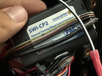

I just figured figured out that the box he was pressing the reset button on was the steering wheel control module? I have no idea what this would have to do with the unit turning on.... He took it out infront of me, pressed and held the blue button, and the unit turned right on. I have no idea what this would have to do with the unit not turning on or sometimes it randomly shutting off while driving?

Those are common, there are several manufacturers that make those. What it does is convert the analog controls from your steering wheel to the digital input of your aftermarket head unit. Right off the bat, if you get frustrated, you should be able to just unplug it, and not have steering wheel controls, but also not have this problem. I think you should do that just to check and just to verify that's the issue.
It's the correct one for your vehicle. What I would do is check the wiring. You need to find the wiring colors for your vehicle, then compare. That exact one works for a lot of vehicle. I have never used one, but you might have a pin that is in the wrong spot for your vehicle. I feel like if that was the issue, I would have heard about that too. I think it's more likely that it's wired wrong if that's it. If it's a hardware issue.
You also might need to program it. Go through here, and read the links. Maybe they didn't program it or reassigned something. It does need programming, and if they are just holding the button, that sounds like it's going into programming mode.
Is that a new item? Any chance that pac is 15 years old, you didn't buy it, and you don't know if it's functioning correctly?

Yes its a brand new item, I am also going to try to unplug it and see if that fixes it. Would it cause it to turn off while driving too? very rarely it will turn off, but it hasn't been happening recently. it is programmed to where a middle button on the steering wheel will activate "Siri" and the other are source, Louder, And Quieter. The only issue is that since this radio does not have a knob to quickly turn up and down the volume/mute it, and that the touch sensors on it are very very small and hard to register and find since during the day since the RGB is not bright enough for the sun (it is cloudy right now so they can be seen easily, but during the sunlight they are invisible), and that it would be a pain to quickly turn up and down the music, or having to constantly take my eyes off the road to find the tiny touch spot to turn the volume up or down. I will also take it out and check if the pins are correct on it and check if the wiring is correct.
