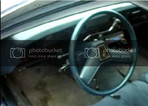

im going to try and replace the ignition cyclinder myself. I dont know how to the steering column apart on my car. I dont if know if mine has a airbag or what....i dont want it to deploy on me...lol
i guess im stuck 4 now..do i just pop the chevy emblem off the middle of the wheel? and there sould be some screws?

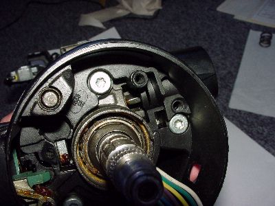

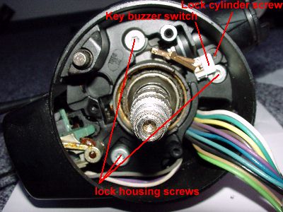

what about the Ignition cylinder screw that has to come out in order for the ignition cylinder to go out or come in.....I dont think you can just unscrew a screw from the bottom an slide the cylinder out as easily as your talking about....im 99% sure you gotta take that screw out inside the column to even take the ignition out.
in your case since they ****ed it up so bad follow these instructions ...
Step 1. Remove horn cover or airbag from wheel. Step 2. Remove the horn contact by pushing it in gently and twisting counter clockwise 1/8 turn. Step 3. Remove clip from center shaft with lock-ring pliers Step 4. Remove center bolt from shaft. Step 5. Use steering wheel puller to remove wheel. Step 6. Remove dust cap from lock plate. Step 7. Use lock plate remover to depress lock plate. Step 8. Use a pick to remove hog ring from center shaft. Step 9. Release lock plate remover and remove it and the lock plate. Step 10. Remove set screw from hazard warning switch from the outside of the column. (if equipped) Step 11. Remove the screw and turn signal lever retainer plate from the left side of the turn signal switch. Step 12. Remove three inset screws that hold the turn signal switch in place. Step 13. Gently pull turn signal switch out of the column a push off to the side. Step 14. Use needle nose pliers to gently remove the small contact clip that mounts just above the lock cylinder. Step 15. Use the appropriate screw driver (they used several different screws overs the years) to remove the lock cylinder retaining screw. Step 16. Slide the lock cylinder out of the column
