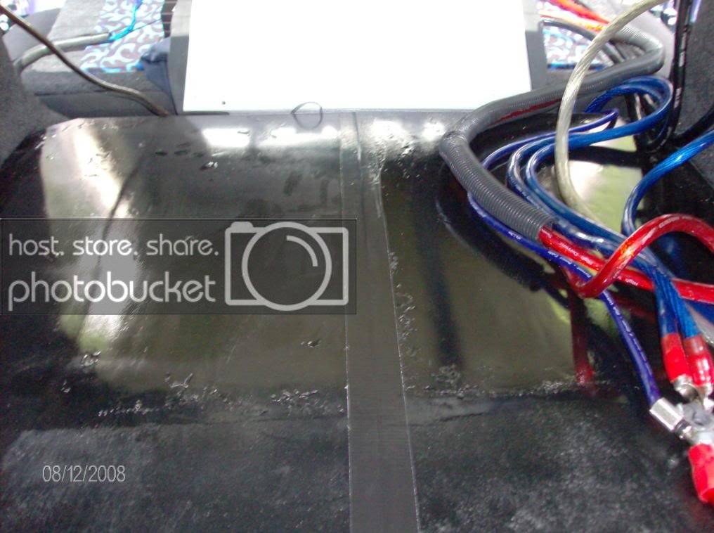

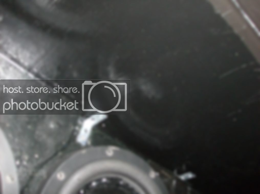

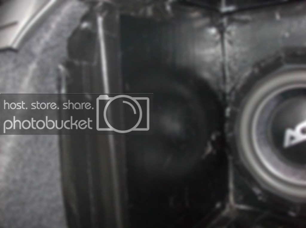

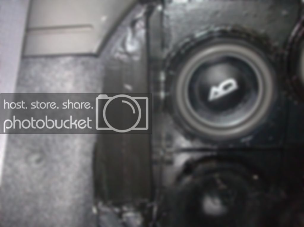

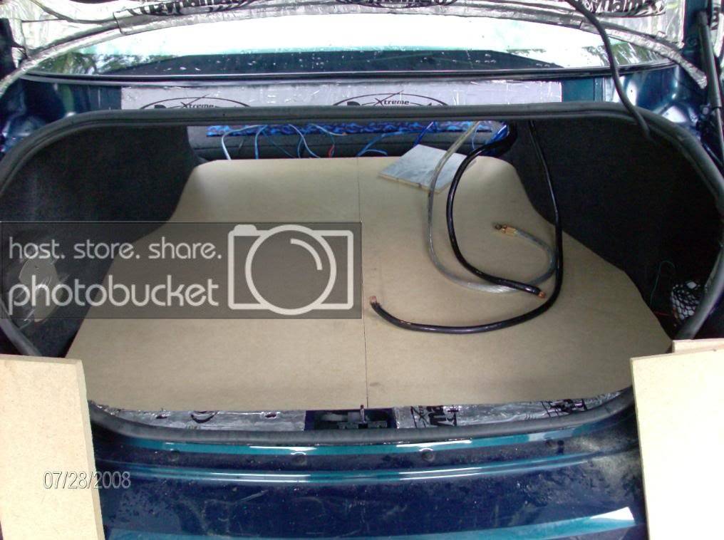

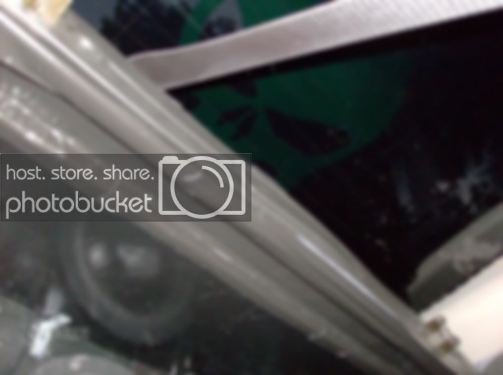

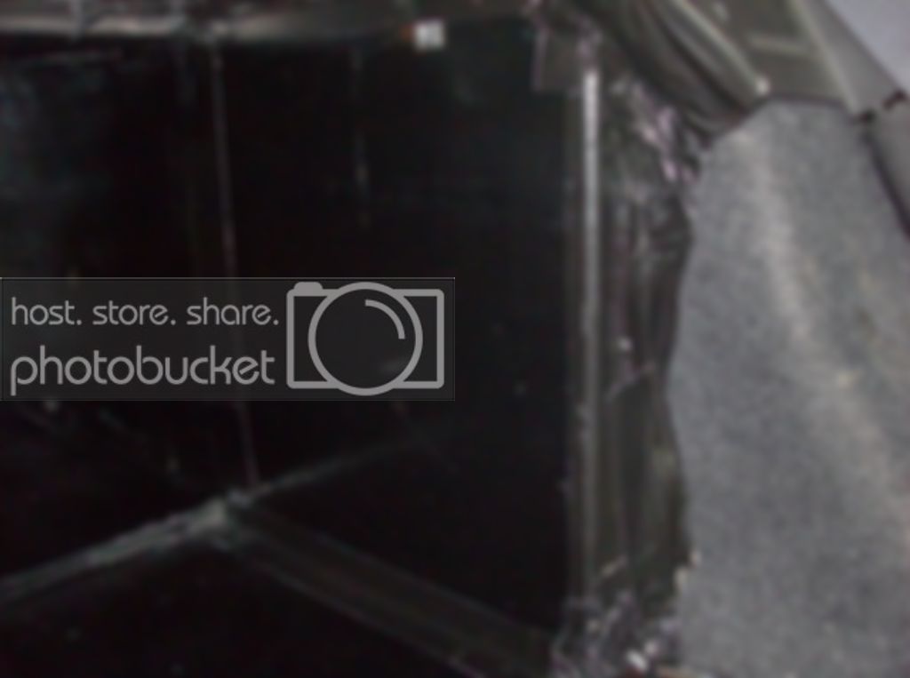

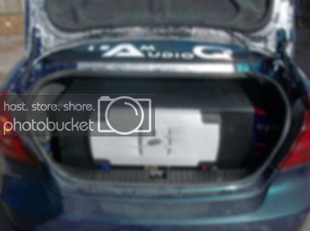

First I started with a floor. After 1 day of testing the box and location I found that box all the way back against the trunk lid centered was the loudest.

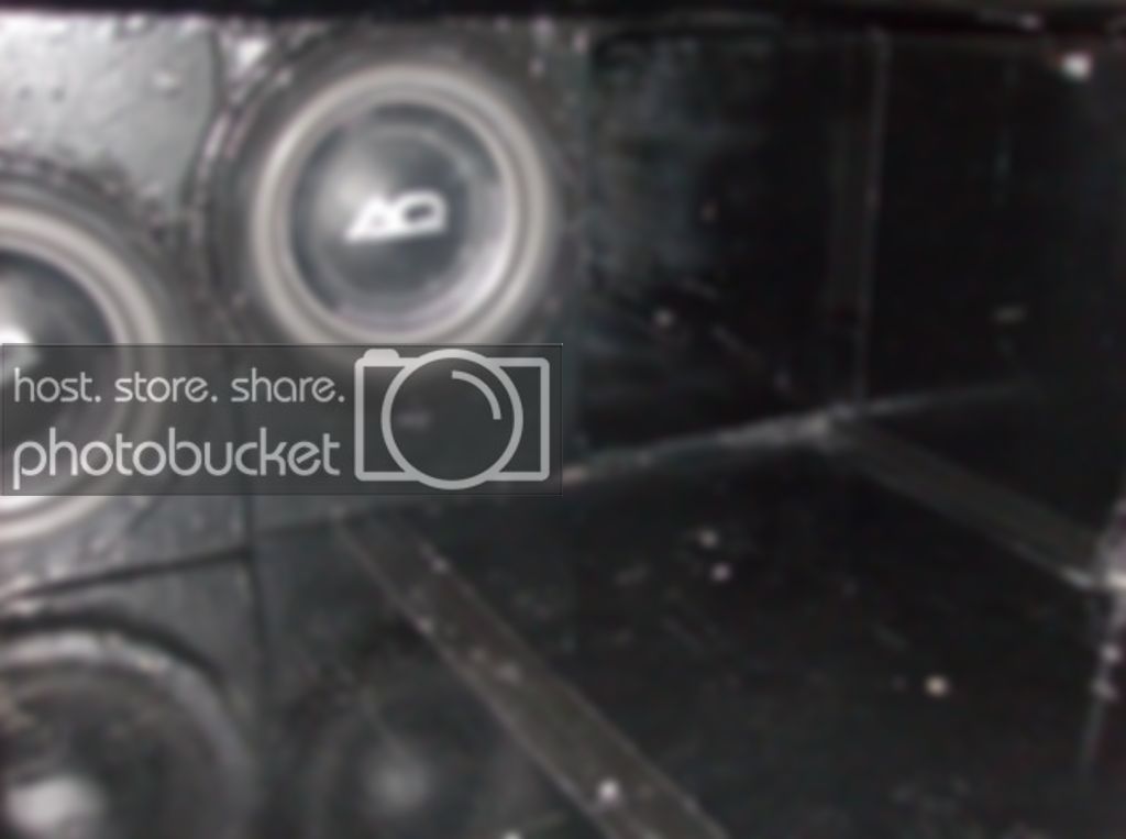

Then I added sides and a top sealing the box to the cabin. It was a crazy Idea I had that gave me a solid 1.5 Db!//content.invisioncic.com/y282845/emoticons/biggrin.gif.d71a5d36fcbab170f2364c9f2e3946cb.gif With the port I got it made a mini wall for my 10's.//content.invisioncic.com/y282845/emoticons/cool.gif.3bcaf8f141236c00f8044d07150e34f7.gif Next year gonna stretch the port 2 more inches for a Monster 12inch Port!//content.invisioncic.com/y282845/emoticons/crazy.gif.c13912c32de98515d3142759a824dae7.gif
get one from your drivers seat looking back at a low angle please. so like put the camara on center console.

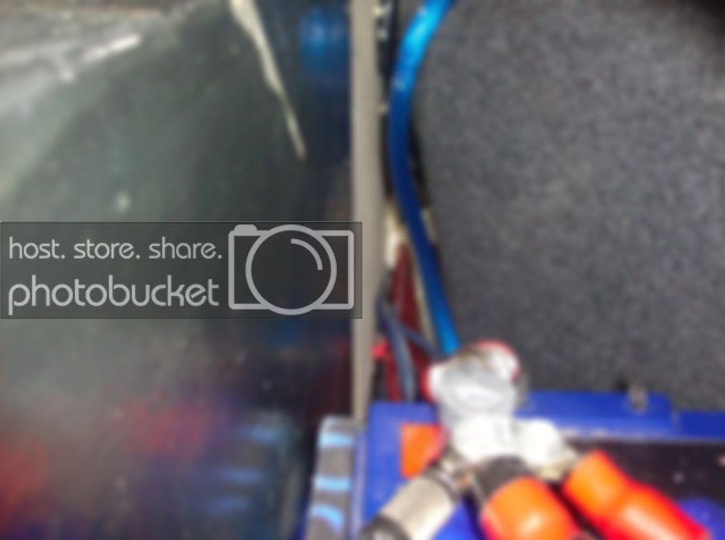

Yeah, but I figured doing it this way would be less permanent incase he didn't like the outcome. But soon I'll be making my little wall's ''extension'' peices made from mdf to block off the airflow the the trunk.
What car do you have Thor? I wanna try my box all the way to the trunk and see if it makes a difference. Right now mines wedged to the front so I have rooms for my batt and amp.
