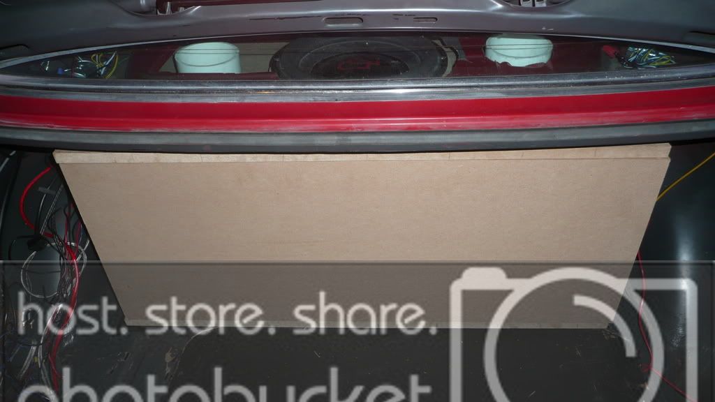

as you can see the box is jammed in the back deck and bolted in many places. The box is 4 cubes net which is much too big. I need around 2.75-3 cubes
If i did a brace in the shape of a cross, would that affect airflow at all?

Actually I can't see, but I'll take your word for it.
However, any bracing (as long as it's not in the way of the port) will effect the pressure. Just keep a good distance from the port and you can put whatever you want in there.
is it truly that hard to make the box square? Some really rough cuts there
Just rebuild the box
thanks for the confidence, if you had looked at the other pictures this pic was when i test fitted the box //content.invisioncic.com/y282845/emoticons/nono.gif.eca61d170185779e0921b0faa9704973.gif
