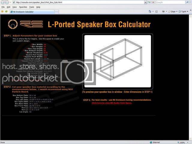

It looks to me that using the OP's design, the port legnth the tool
exhibits is 24.75", the actual legnth is 23.75" and if you build the box
with 23.75 with 2.9cft of volume your tune would be deeper than
30.844; by my calculations anyway. It appears re is adding the displacement
of the wood used to make the port to the figure of 2.9 (ft3). When you calculate
2.77, which is the actual ft3 displacement, the port measurments are
correct (or very close). The 24.75 measurement they use for port length
is one I cannot explain, they are just adding an inch that I cannot account for.

The ported calculator on BCAE1.com works just like winISD, i do a little try with all the box calculator i can get, and BCAE1.com, winISD and re tool (total lenght) and some formulas i found here and in ROE forum give pretty close numbers no more than 1" between then, but bassbox pro give a little bit off port lenght to the same tuning.
Now i'm using BCAE1.com to calculate port lenght winISD to confirm that and bassbox to see vent velocity and some other graph and data than helps me to design a better box.
PS: Re tool dont give correct numbers, the total lenght of a port should be measure in the center of the port, no matter how i calculate i couldnt make the L1 and L2 to make TL (total lenght) i draw the box in autocad and measure all the posible situacion and coulndt find it, so they might be bringing something to the equiation that i'm mising.
It's not that off, pretty on point IMO, when I compare it to other calculators. It's just that the RE calculator measures port length on the outside wall, like someone stated before. Don't be hesitant to use it.

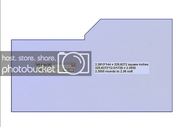

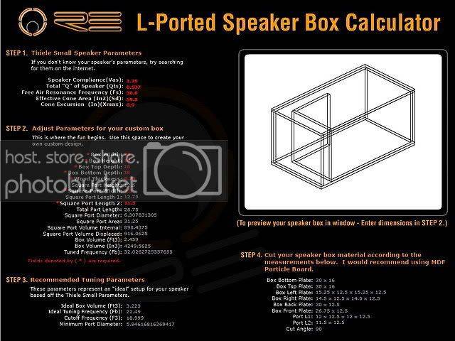

Wow yet another thread on yet another board discussing the accuracy of the RE Calculator. First and foremost its off, but not so drastically that will render it useless! For example, say you wanted to build slot port enclosure for an FI Q12 subwoofer. After some thought your initial plan is for 2.3 cuft tuned to 32 hertz.
After playing around with it you get 2.459 cuft tuned to 32.026 hertz with 31.25 inches of port before displacements, which you believe should work. Now if you break that down and use WinISD Pro or even any accepted formula (say the one from JL Audio on Ports) you will get the results below. In this case I just used WinISD Pro for the ease of automation of the port length. I also included the equation below if you prefer using good ole mathematics. Even taking the 28.75 total port length into account (end correction adjustment) you will still be off after displacements.
Here is design straight from the calculator. (old version 1st new version 2nd)

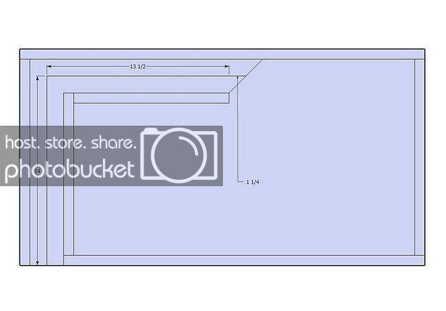

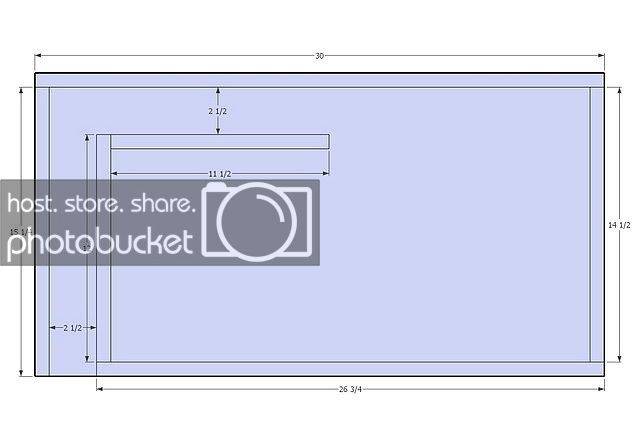

Modeled in SketchUp.
Actual port length.
The calculator shows 28.75 inches, to account for the end correction, and yes you can see that the actual port length (taking end correction into account) adds up to 28.75 inches.
Volume of the enclosure before sub displacement (as you can see all other displacements accounted for i.e. port including end correction).
Now take into account the subwoofer displacement (Fi Q has 0.16 cuft). So now your net volume, all displacements taken into account, is 2.2 cuft. Just plug the new variables into WinISD Pro, so now your enclosure is actually 2.2 cuft tuned to 34 hertz.
Or if you prefer good ole mathematics. (the formula below differs slightly from the one on JL Audio site, but thats due to the conversion of cubic inches to cubic feet)
  • Fb = 0.159*SQRT[(Av*(1.84*10^8)]/(Vb*1728*[Lv+(0.823*SQRT(Av))])
  • Fb = 0.159*SQRT[(31.25*(1.84*10^8)]/(2.2*1728*[28.75+(0.823*SQRT(31.25))])
  • Fb = 0.159*SQRT(5750000000/126783.36)
  • Fb = 0.159*SQRT(45352.95)
  • Fb = 0.159*212.96
  • Fb = 33.86
So you are off a tenth or so of a cubic foot of airspace and around twoish hertz in resonance, in this case. What does this all mean? Its simple, the calculator is far from accurate but will produce a bassheads daily trunk beater. Which I believe was the intent in the first place. Now get me a d@mn liter of cola, and liter is French for give me some fawking cola!
