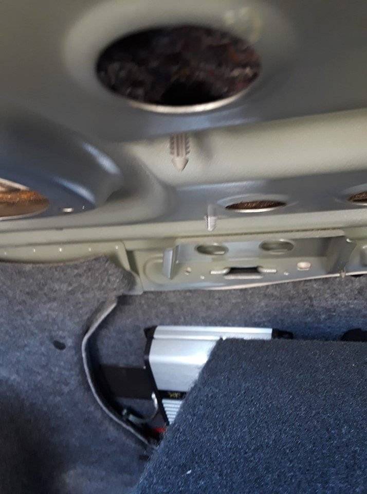

I also wanted to mention. How do I put in the dynamat when I'm dealing with clips pointed down along the trunk. Do I cut holes around these clips? Here's my picture where you can see the clips pointed downward.

Its so much easier to put small sheets of sound deadner on like 8"x8" or up to 10"x10" or 12"x12" rather than large pieces for me.That way I can roll and make sure that it sticks well after preping and cleaning with alcohol,.. I use a heat gun to warm up and roll on to stick better. I have ran up to 5 layers of 80 mill. before in some areas. You can cut with a sharp pair of shears or scissors to fill in gaps,.Work all four corners around them, Not hard, easy enough. Dont expect to be able to do the entire trunk in one day if you want to do it correctly and look decent/Nicely done.,unless its slapped on.
I also wanted to mention. How do I put in the dynamat when I'm dealing with clips pointed down along the trunk. Do I cut holes around these clips? Here's my picture where you can see the clips pointed downward.View attachment 18331View attachment 18331View attachment 18331View attachment 18331View attachment 18331
Looking at the pics where your amp is mounted...I recommend you place at least 3-4 washers under all four at at the minimum Caddie/ corner on the amp bolt down pegs to raise that amp off the flat surface to get some air and space between that amp and the surface, to help keep it running a little cooler as it is already hot in that trunk space.Id loom at a scroll fan (Fans are cheap!!) as well to help with the heat.keep in mind.. sealing off that trunk and its going to get warmer in there as well. Just an FYI
