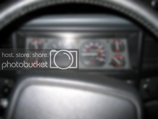

omg. its very simple.
All you have to take off is the bezel that surrounds the HU. Thats all.
At the very right of this picture, to the right of the gauges, is a black face where lights normally go. If you take off the bezel, you'll see this unit. It is empty. There is enough room to go from BEHIND this unit down to below the dash.
