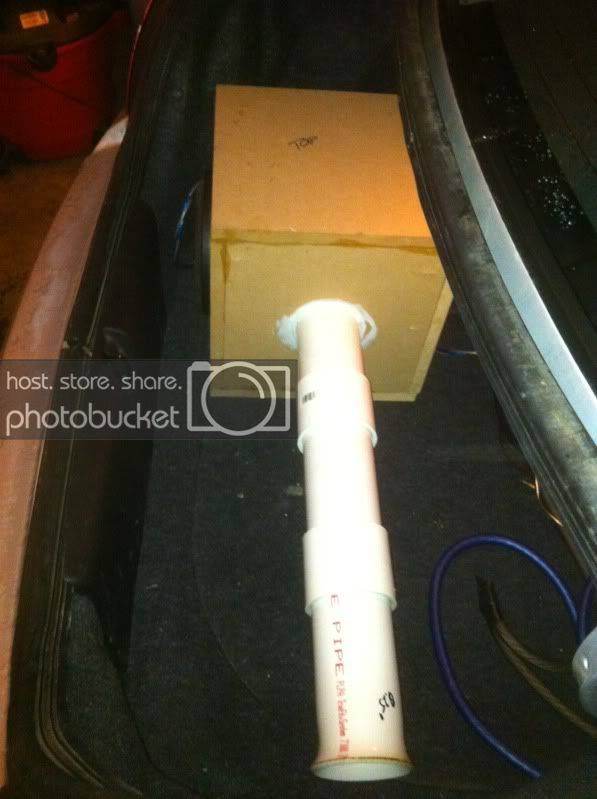

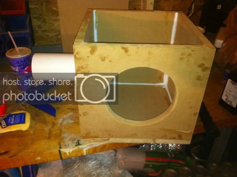

this is the box i built for testing 8s. i just used 3" pvc, a pair of couplers and various lengths of pvc between them to adjust the tuning. it won't win any aesthetic competitions but it makes adjusting the port very easy.
