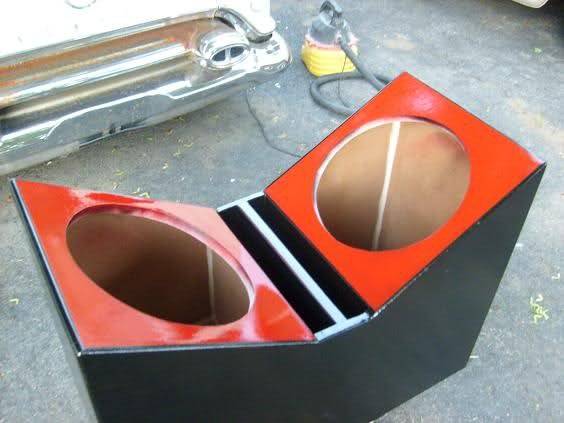

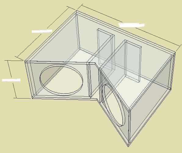

I am aware of what it is. First question is .... is it a 4th order, I lot of people say this. And if so what is it tuned to. And I know it helps if you have a lot of woofers to put in a small space. But honestly is there a gain over say a normal ported box? what are all the benefits of clamshell?
in theory, this 'push/pull isobaric' system would decrease the air space requirements by half, and reduce distortion. the output of both subs working together equals the output of a single subwoofer. I don't know what the rolloff would be, but I would assume its like a basic sealed system. there were also vented and dual chamber systems as well. however, by this time, the advantage of less space disappeared very quickly. Kicker introduced their original Solobaric subs, which worked well in super small sealed boxes. other companies followed through with high mass, low sensitivity subs that required small spaces. the 'clamshell' setup more or less disappeared soon after.
I think it does if you constrict the end of the clam shell into a port. The area behind the sub is the sealed part, the "clam" is the ported box volume with the exit out of the shell being the port
